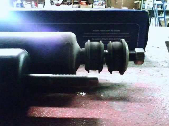

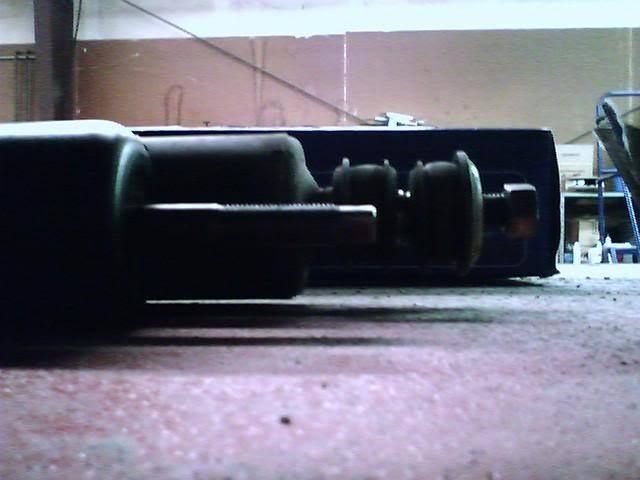

Ok, finally got to the shocks. Installed them yesterday on lunch break! Shocks are Gabriel ProGuard #61501 for 1987 Isuzu pickup. They are 2 inches shorter than stock. The ride is much better now. Here's the pics I took on the lift. (Stock behind Isuzu) Is anyone running longer shocks for the back? They need replaced too, and I have the 3" blocks back there.
