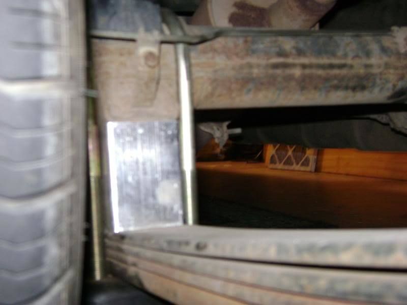

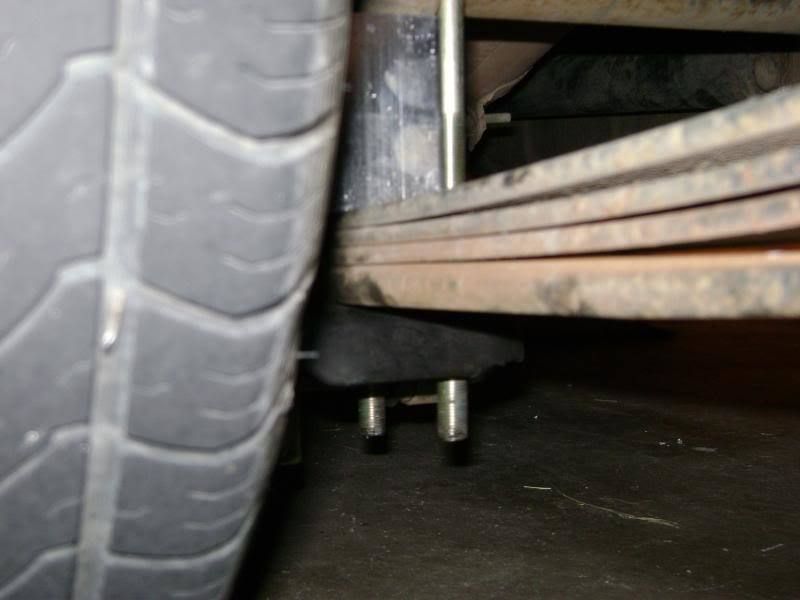

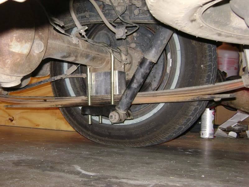

lost_b2200
Blocks are a cheap drop. $35 w/tax at autozone for 3" drop. Front torsion adjuster bolts were a nice gold color like the new U-bolts. No rust on them, dropped real easy. Went 3 turns on the passenger side & 5 turns on the driver side. (Truck has always sat higher on driver side). It doesn't now though, both sides are 27" to the top of fender arch. Will be cutting extra U-bolts off this weekend after the torque is rechecked. Everything took about an hour, but I did have it on the lift and was walking around under it.
Here's a few quick pics of the blocks put in:
