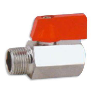

Can't you just go to Home Depot and buy a couple 3/8" ball valves?
Something like this?

I would personally pick up some mini ball valves....Cheap and adjustable!
