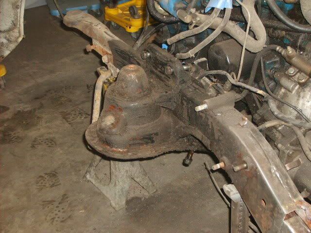

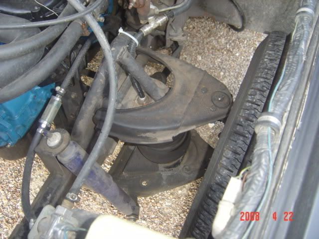

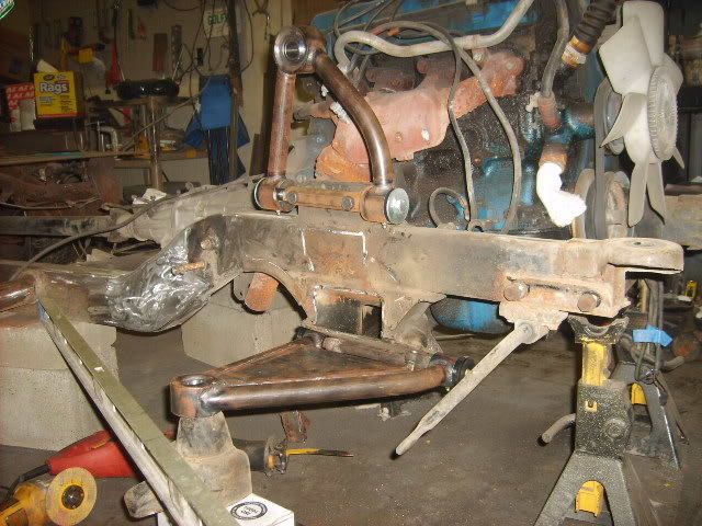

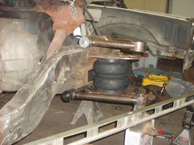

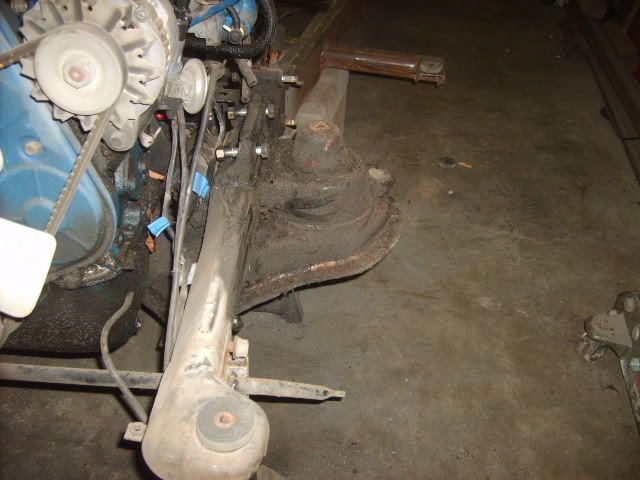

This is my buddy jerids courier, same truck as ours but just a ford....
Here you can see the actual spring pocket
[[/IMG]
Picture of mine with the spring pocket cut off
After capping off the open area to prevent weakness in the frame.
You can see were he started the front torsion kit but never finished.
We havent finished the front of mine yet so when we do ill post pics.

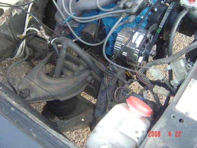

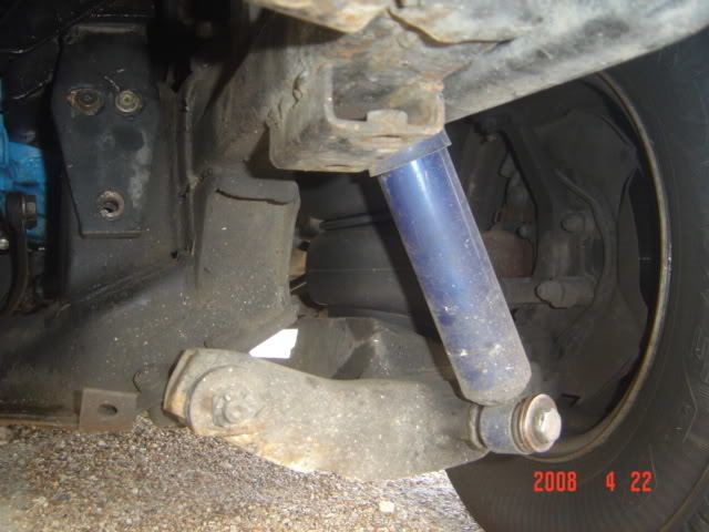

slammed83.. is that frame "Z-ed"
if you choose nto to Z your frame you will A) lay and drag control arms,, but B ) your upper bag mount instead of being 90 degrees from the frame will be more like 30 degrees on an upward angle like this..../
fattirebicycles's avatar
fattirebicycles
I am currently dealing with the no-z setup right now. It lays control arm and frame simultaneously. I pie-cut the uppers and lowers to get out of balljoint lock, and I'm raising the upper control arm mounts 1-1/2 inches to make more room for the 'bag. I don't have a problem with z'ing the frame, but whereas I'm bodydropping it, that moves the steering box pretty high in the firewall for my tastes with the z. Watch my project log in the under construction section for more info/pics. "fattirebicycles' '81 courier"

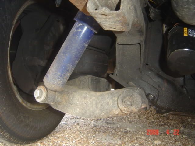

fattirebicycles
This is more than enough notch to lay frame on a 26" tire. The bottom of the notch is 1-1/2" above the top of the existing frame. The truck is laying frame in the pic.
The curved gusset right behind the front crossmember on the bottom of the frame must be removed in a no-z application.It slightly interferes with the tie rod. you can see what I'm talking about in slammed83's next to last pic. (above)
