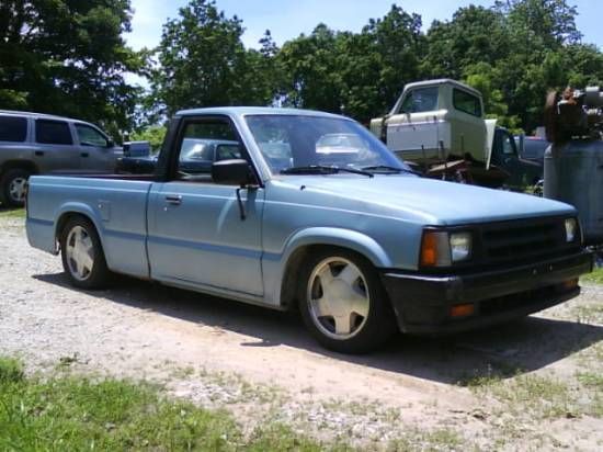

I did 5 splines on mine. If I knew how to post pics I would. I can e-mail them to someone. I also cut off the bump stop and the mount that was welded to the frame. The rear I did 3 inch blocks and pulled 2 middle leafs. that is a link to my mautofied ad,
twitch
hungry&fat...heres ur ride
