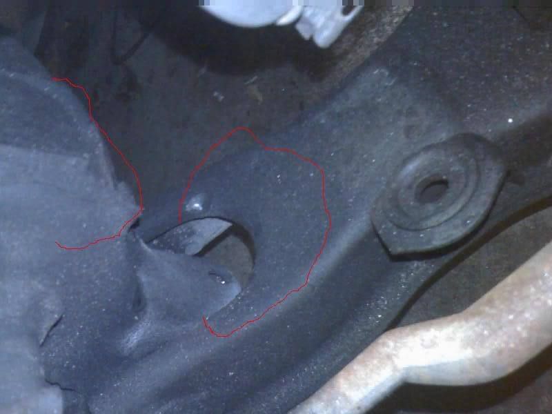

back working on my truck any body got pic on how to lay the front out cross member i took my blocks out up front but i wont it to lay out with out them and i was looking at cutting the a-arm but i dont see that helping me any i got 18's on it and i need about a inch or half inch to lay all the way out dont wont to cut a-arm becouse of hydros to much power mite rip them out all the way

do you have your lower control arms notched

you talking about this right.
just make sure you plate the control arm after you notch it and dont make str8 cuts make sure you round the corners

You for sure have to cut that lower arm up you need to remove quite a bit of it

what about the plate on the fram rail were the bump stops use to be cut that off to
