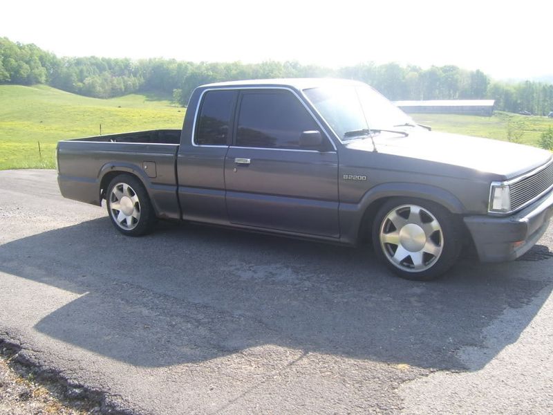

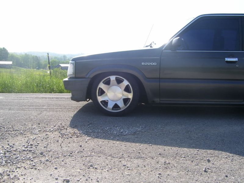

My truck is driving really shi**y. It darts from left to right, it bumpsteers, sometimes the wheel is hard to turn, sometimes really easy. I don't know what's going on. It's got 4 new tie rods and adjusters, new (flipped) balljoints, new idler and pitman arm. I completely cut off my bumpstop brackets, re-indexed the torsions, put on shorter shocks and trimmed the upper shock mount to keep the upper control arm from hitting it. I have one of the inner fenders cut out and I'm working on getting the other one out I can see where the pitman and idler have been rubbing my strut rods. It also looks like my shocks are leaning but I can't remember which way. I'll get some pics of the front suspension from different angles tomorrow.
When I had it aligned the camber was pretty close to being even on both sides. He said the caster was off very little too. It's pretty scary to drive because you never know what to expect. Sometimes it seems fine though. The only things I can think of are maybe something with the strut rods or the control arm bushings. Anybody have any other ideas? I really don't want to raise it back up. Here are a few pics.
That back has got to come down to match the front too!

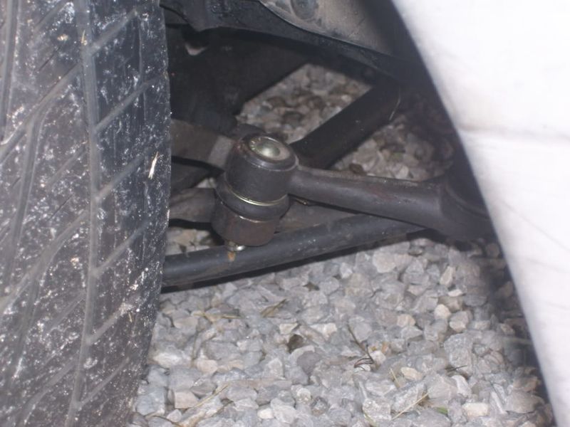

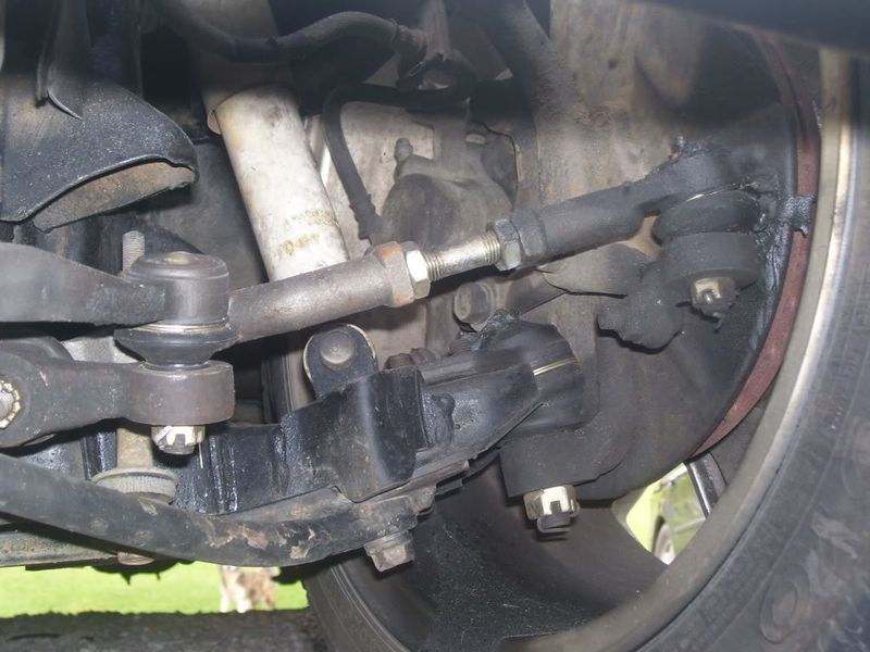

but sounds like your steering is dragging across your strut rods. Might have to raise it a touch or look into fabbing some new strut rods.

Ok, I've got some pics now.

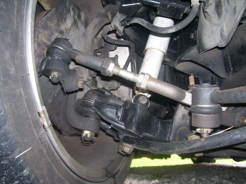

Here's the passenger side with the wheel cut all the way to right. You can see were the idler arm is rubbing the strut rod.

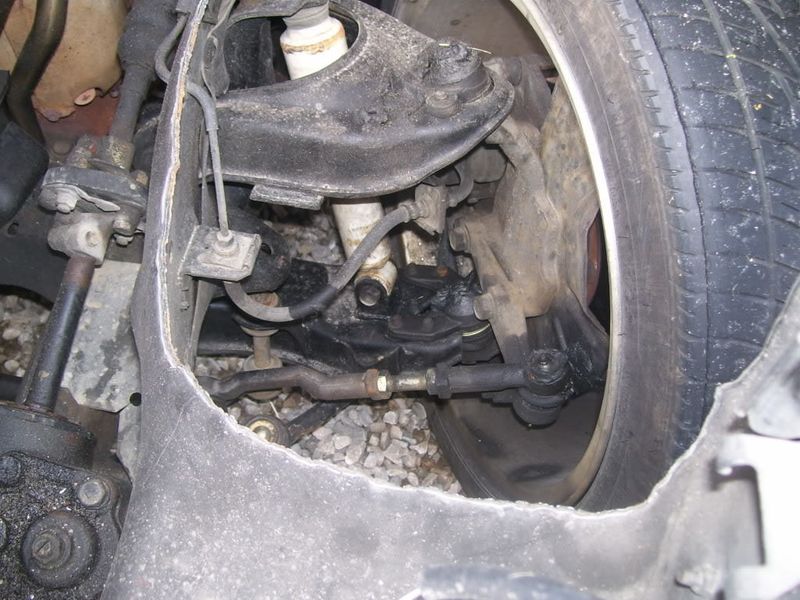

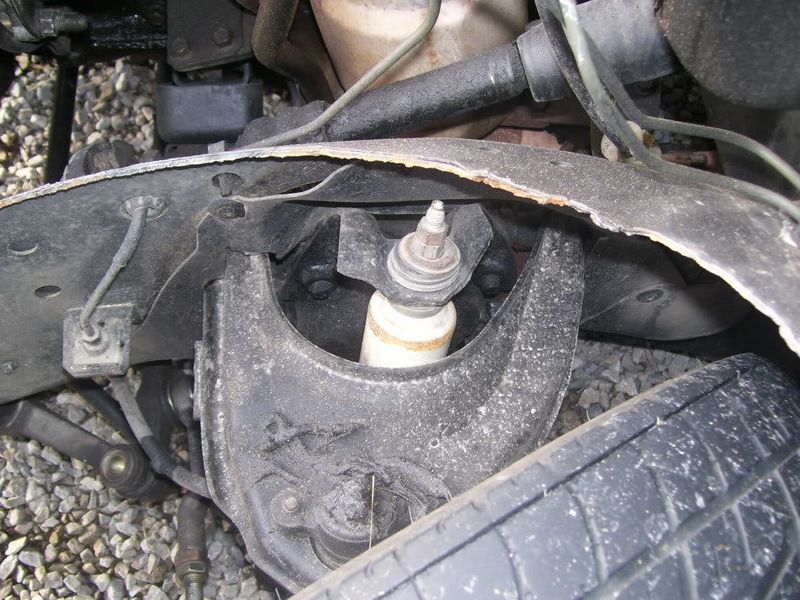

Here's what I was saying about the shock looking like it's leaning.
Here's some shots of the driver's side with the wheel cut all the way to the left.

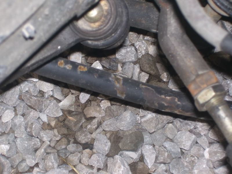

Here's where the pitman has been rubbing the strut rod.
