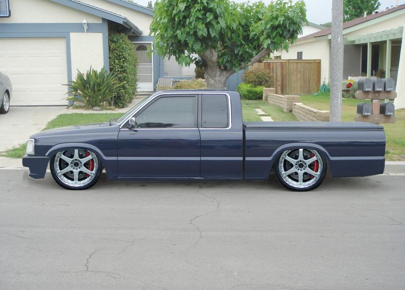

How low can I go without ruining the ride on my 90 Cab Plus? I have a F'd up low back (L5/S1 Fused) so it cannot ride much worse than stock. I just want to do a static drop, blocks & crank down the torsion bars.

This is perfect, but not practical...Thanks to Photoshop
