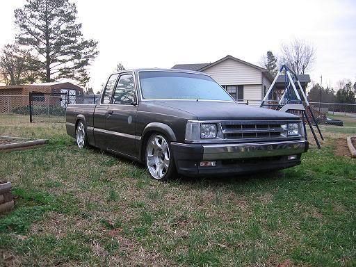

heres how my truck sat last year. front bump stop mounts cut out for clearance (gotta cut them out eventually to bag it), flipped lower ball joints, reindexed torsions, and shocks. the rear i monoleafed with the overload on top, 3" blocks, and air shocks. front rode great, the rear bottomed out with no air in the airshocks. im sure with a half-notch it would have been better. thats my .02.

i love the look of that!, i think its perfect height untill i bag it
