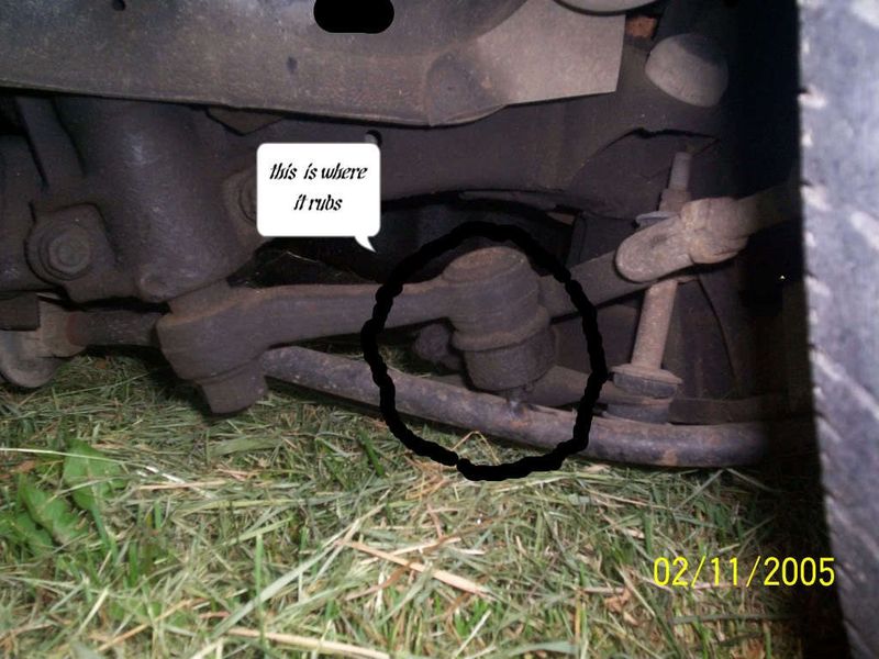

ok guys need ur help i have a problem with the driver side suspension the torsion bar is cranked down and when i turn the wheel to the right the bar for the steering wright at the joint rubs the bar right under it could the shock be bottomed out our what could it be pls help if u need pics i will try to get them up tommorrow

ok guys here is the pics sorry it took so long but maybe u guys can help
and when u push down on the passanger side it doesnt move but when u push down on the driver side it goes down real easy, could it be the torsion bar or shock or maybe the bushings, so please guys if u can help it would be great

Well, the driver side arm there is called your Pitman Arm. It is for your steering. The other arm just like it on the passenger side is the Idler Arm.
Now, if you've got any slop in these components you need to raplace them. As well look at the sway bar and see if it has any play or the bushings are out on it.
You should give your whole suspension a look over and see is something is shot.
Shocks will not do this, and it may be that you have your torsions cranked down too much?
And now that I look at that pic a little more it looks like your pitman arm is hitting the strut bar. You may be too low? Are you riding bumpstops?

it doesnt have bump stops they where cut out when the ball joints where flipped and the dricer side is sitting about a quarter of an inch higher then the passanger side could it be that ive lost the tension in the torsion bar
1lob2k
another question to ask bro, is, why does it only rub when there is weight in the truck? Why does the other side not rub the same under the same weight?
