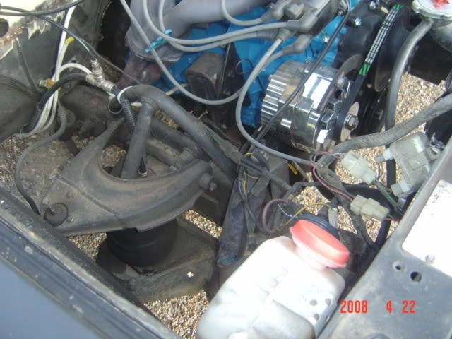

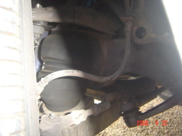

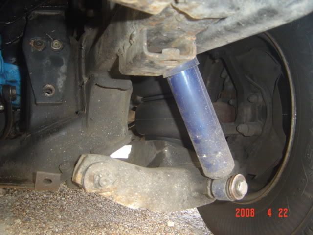

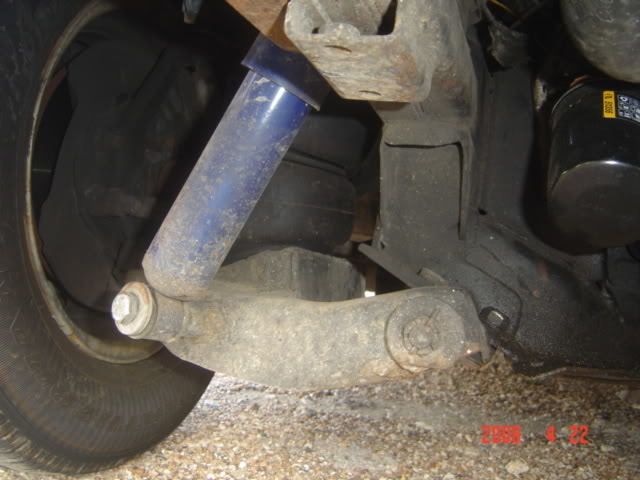

this is about the best i can do for pics until i pull my front tires off again man. here you go...
maztang (ryan)'s avatar
maztang (ryan)
you should really z the frame about 1-2"s (don't know for sure yet cause i haven't done it yet) for clearance on the lower control arms. you an see in the 3rd and 4th pic how they drag. but i do believe they only do it when i lay the front down and raise the rear up and drag front crossmember.
also, you will want to build a gaurd for the oil pan. once again, on the to-do-list. haha.
i had a bad encounter with a speedbump and my oil pan lost big time. so i had to replace it. luckily i had a spare already.
