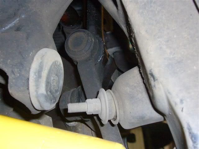

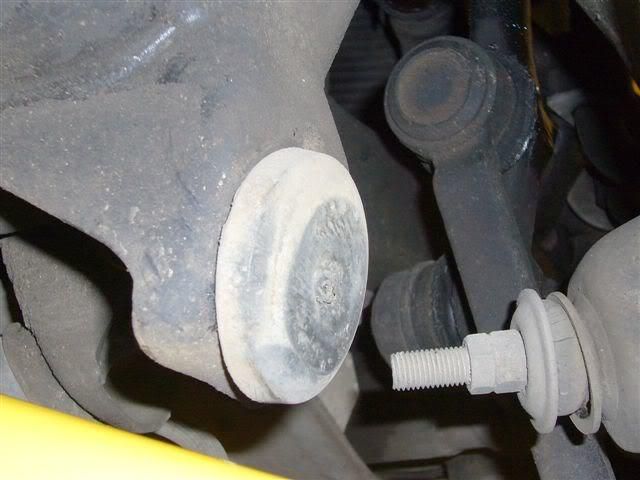

what is this????
636 views
3 replies
what is this????
ja2000
and what can i do about it bottoming out????????
twisted minis's avatar
twisted minis
Its called a bump stop. If you cut it off, you won't bottom out on it. You will just bottom out on other stuff.
ja2000
yeah i figured thats what it was but there is another one further up towards the top of the a arm is that really the only way to stop the bottoming out?
twisted minis
Get drop spindles or drop arms, and raise the torsions back up.
