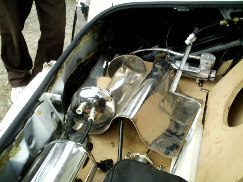

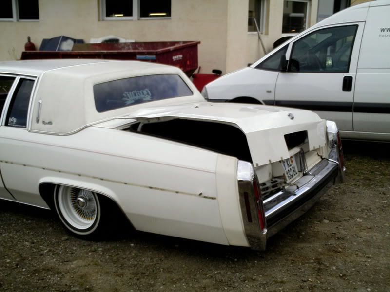

It has come to our attention that some of the Stainless Steel 5 Gallon 9 port DNA tanks and some of the Chrome 5 gallon 4 & 9 port tanks have blown up.
I want you all to be aware that these tanks are NOT DOT APPROVED!!! So if you want to be safe make sure that you spend a little extra monies and buy a tank that is DOT APPROVED!!!
And to be on the EXTRA safe side, stay away from Stainless and Chrome!!

Damn that would be pretty nuts. The thickness of the steel being used definitely isnt even close to being enough.

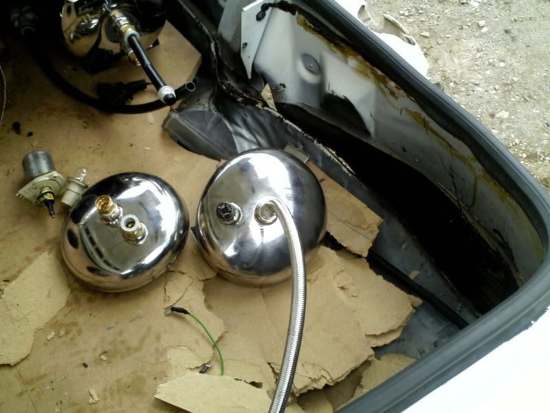

WOW!!! Look at how you can see rust on the freakin weld...poor craftsmanship. Thanks for the heads up.

different car same DNA brand tanks, they are being recalled now.
