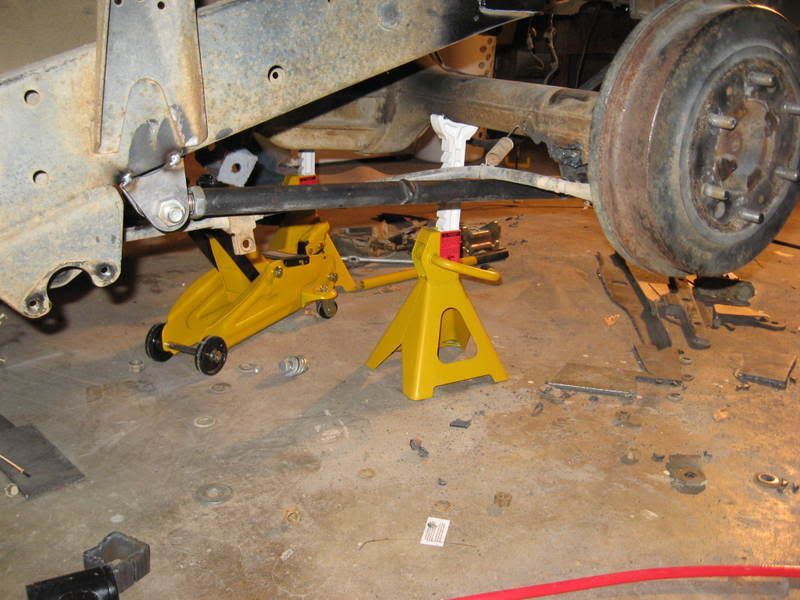

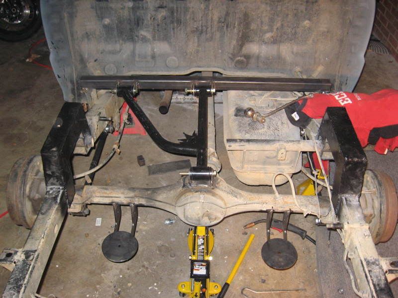

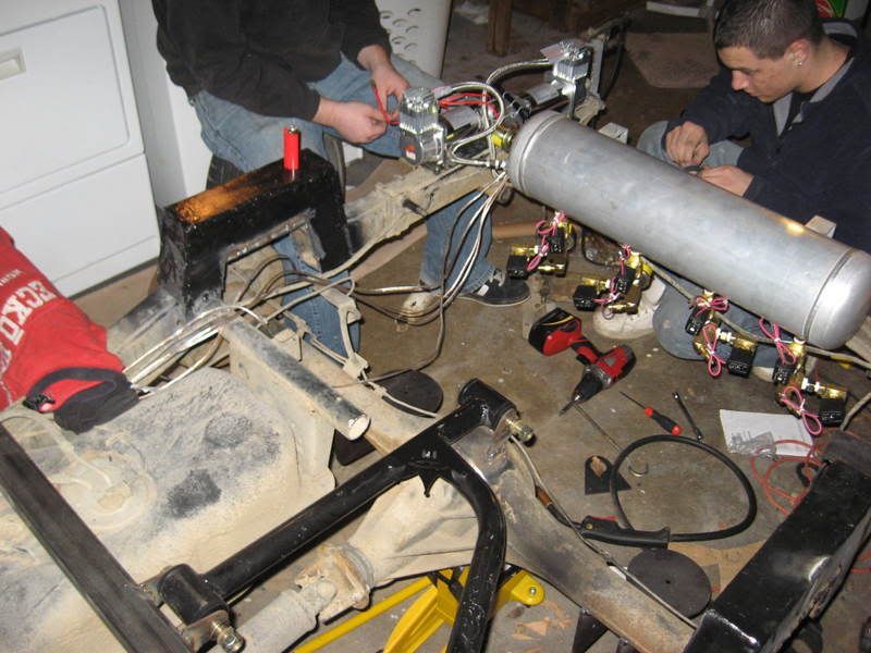

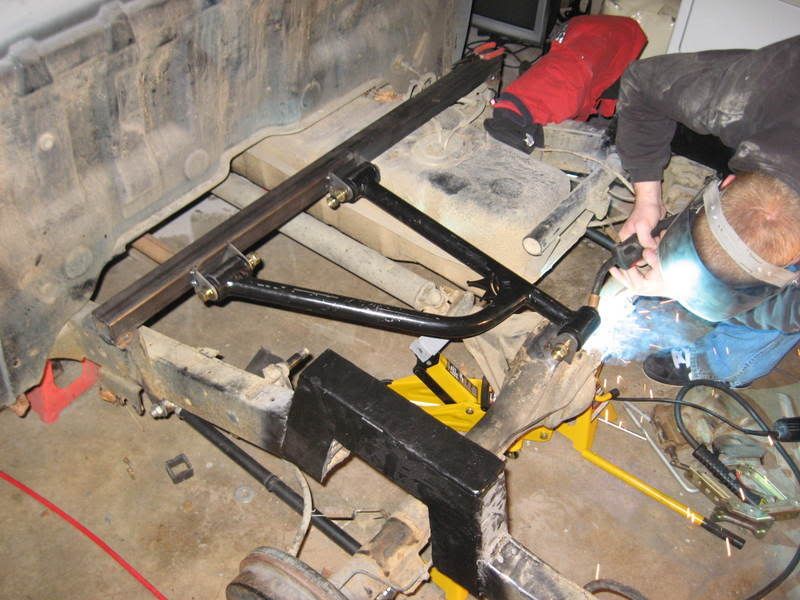

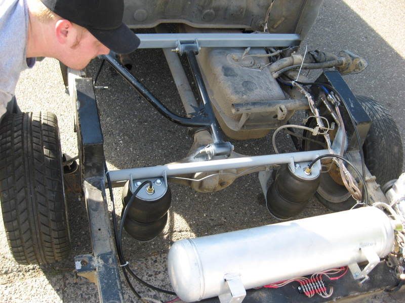

I have a 3-link, Its a triangulated 3-link, Two normal lower bars, and a Triangulated upper link bar Seth (TwistedMinis) Made for me. It works really well, I like it, I went this way because I didnt wanna move my tank from its stock location, Surprisingly enough it pulls an awesome side to side, Only did it once cuz I dont wanna kill my bushings lol.. Heres some pics of mine...
If you need/want more I can get more..
