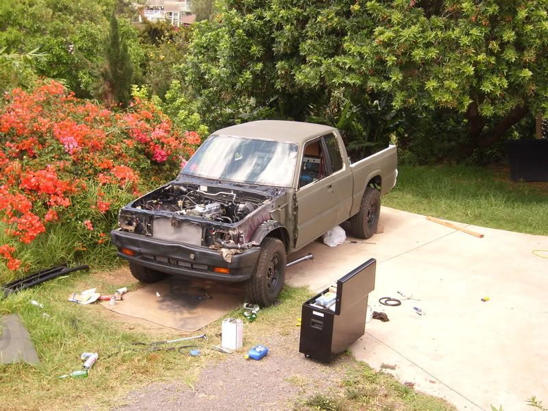

i just got my truck running a week ago, after sitting for 6 months. but after driving it, the suspension feels like it does nothing. this is the bounciest fucker on the road, it absorbs nothing, i cringe when i see dips bumps holes rocks yadda yadda yadda. its not slammed dropped raked lowered at all, its lifted as far as the torsions go, and long shackles in the back.
after lookin at my front end when it was sitting i decided it all needs to be rebuilt. all the bushings are split, the balljoints are ripped right open and have no grease in 'em. i just ordered all the front end pieces, so im about to tackle that
but im just wondering is it always gonna be bouncy. it doesnt seem right, i can look at the shocks to, but man, do you think the ball joints will make it better
