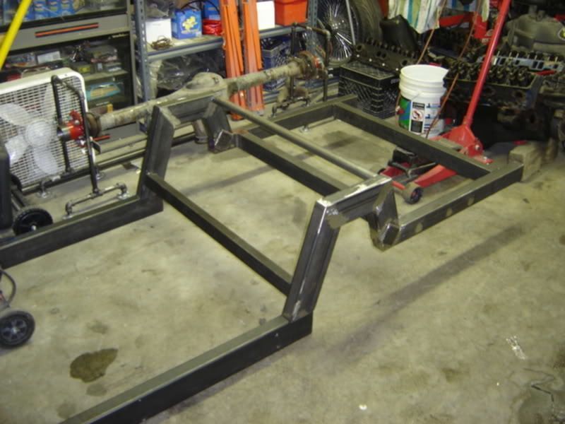

My buddy bought a previously bagged mazda and he wants me to fix the notch. I trying to get him to do what I did to mine, I think if I were you I'd do the same. Heres what I'm talking about.
baggedb22
Time to backhalf it...
dragginmazda86 (dave)
Exactly.
V
v8mazda4ever
ya time to chop it back half it would be the best way to go new steel and a fresh start.
audioinmotioninc
i think you shoule backhalf it... if you like the spider web design then trim that as close to the ends as you can so you can reuse it on the new backhalf.... but i would cut the center bar (the one over the bag mount) down enough to weld to the edge of the bag mount if you choose to keep the center bar. if you dont want it then start fresh and build it the way you want it... but remember measure twice and cut once.

Man, that looks like a lot of work!!! This is the first truck i'm doing and not sure if I cauld make that come out right or I probably could but would take a long time. My gole is maybe to have it driveable by summer some time. What about the rearend, how do I get it back in the right place? I'm not afarid to try it but will probably be asking a LOT of questions. To me the notches seem easier.
immortal1 (linn)'s avatar
immortal1 (linn)
Relocating the rearend is not really that difficult. Once you have your truck setup in the garage take several measurements (straight and diagnal) as to where the rearend is NOW. Draw out your diagram and staple it to the wall (otherwise if you are like me, you will loose it LOL).
Also note - large chuncks of cardboard are VERY handy when it comes to layin out the frame rails.
