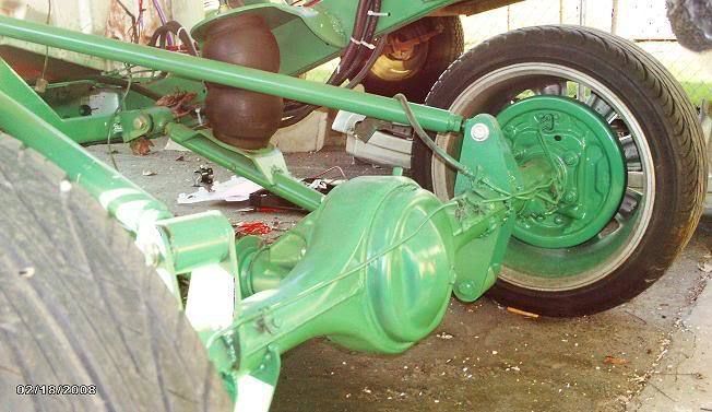

ill make it a mission this weekend to go the parts store to compare some lines. good idea on calling pro comp or explorer. oh heres a pic of the rear up. i think its about 18" or more of lift above the axle.

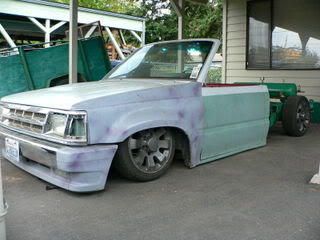

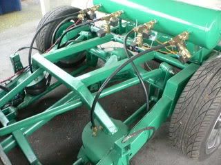

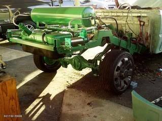

bags are WAY up on the lower bars. the upper brackets had to be tied in to each other to keep them from bending up. kinda of a bag tower brace. ill end up shortening the upper bars and mounting their brackets under that bag bar. then shocks. everything got a quick ass paint job to keep it from rusting. this thing lifts like mad. with 5/8" airline it reaches the top at mach speed. i think blazerpimp has the right idea with a chain bridge. i had one when this truck ran a 2 link and it doglegged like crazy. maybe ill try it again.
