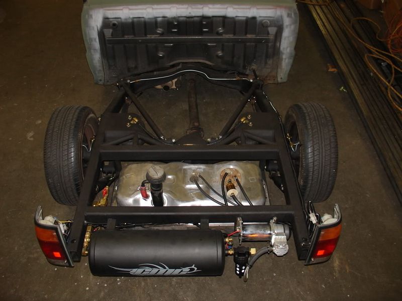

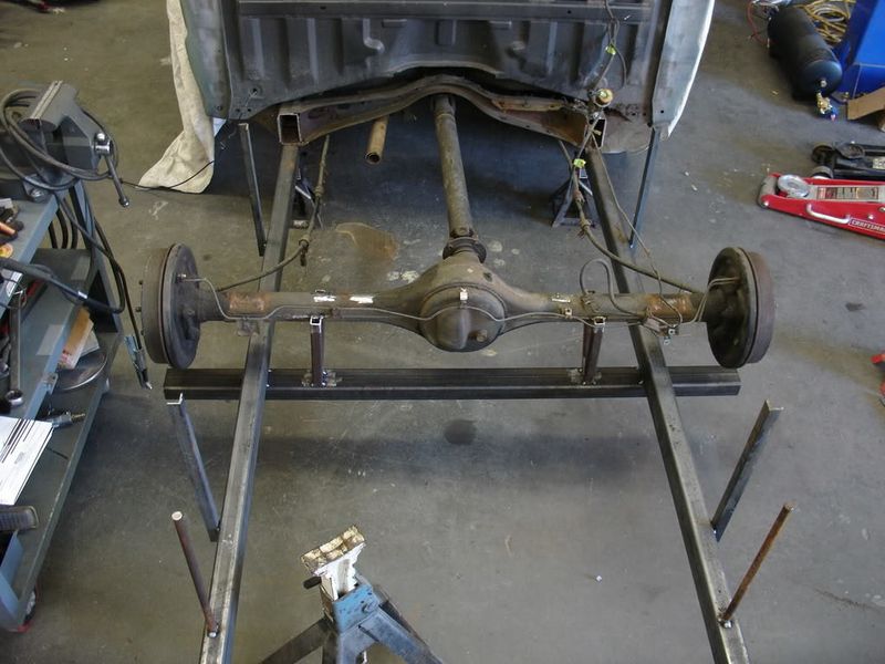

This is how the break lines are supposed to be run
dont put a tee behind the cab...it is a pain and it is hard as hell to bleed even though it does clean the frame up nice...notice how on the pass. side there is a feed and return line going to it thats cause the pass side wont accept a bleeder valve dso you gotta put in another tee...just run them stock

Thanks, those pictures show EXACTLY what I needed to know. What paint did you use on your frame?
