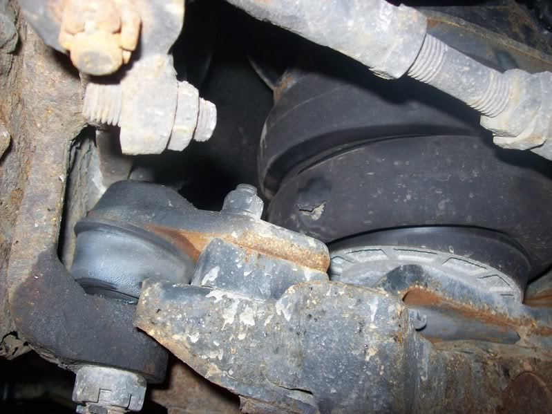

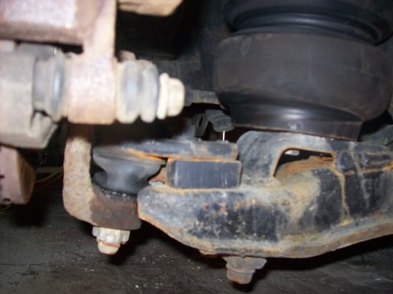

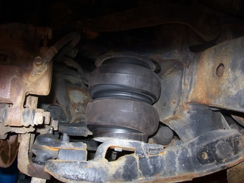

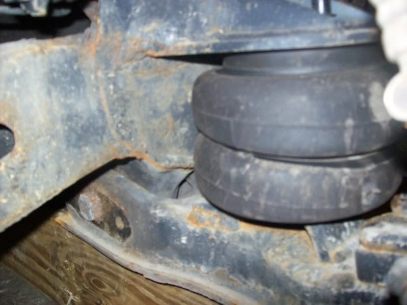

so i took some pics of the setup today let me know whats goin on here guys. i dont think the bjs are flipped and the way the spacer is in there isnt it lifting the truck??? i dont get it. but you can see where the bags are rubbin the bolts. i think if i remove the spacer and flip the bjs like in the how to write up then i should have room and still lay out right? thanks alot for the help guys. also posted some new pics in the garage let me know what you think of the truck.

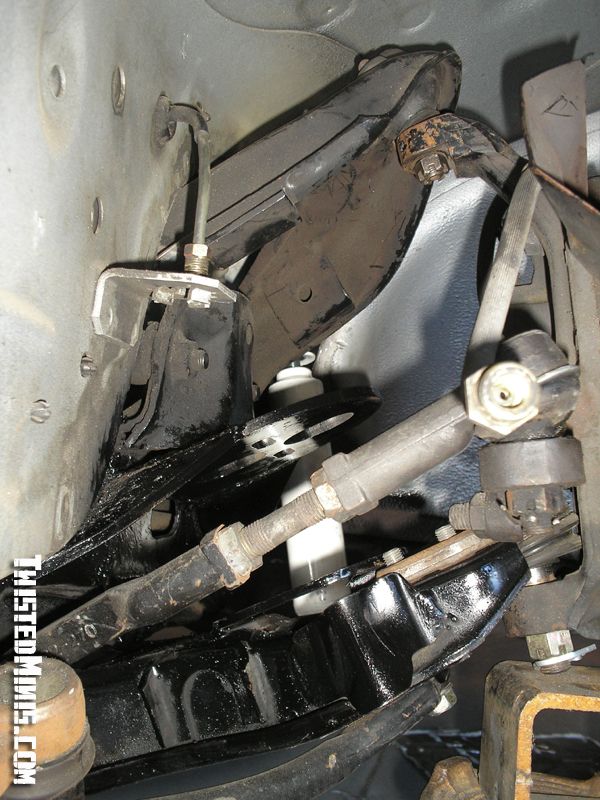

Well first remove that spacer. The upper bag mount should be angled so the bag is straight when its collapsed. Doesnt look like the lower control arms are notched either. Either one of those could be holding you up from laying all the way out or a combination of the two. Check out the how to Dev did to see what I mean about the bag mount and notching the lower arms

the truck lays the entire crossmember right now. im just worried that if i pull out the spacer i wont lay out anymore. because if i pull it the wheel would be closer to the ground right?
so my bj's are allready flipped right?
