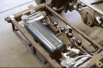

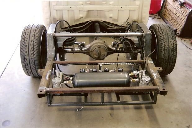

This was my setup when I first bagged my standard cab a few years ago. I don't have a pic when it was completly sheetmetaled in to protect ever thing from the elements. Never had a problem with it like this.

^^ My fuel cell was up in front next to the cab, centered in the bed with one optima battery on each side. Like Devons 4x4 bed that hes trying to sell, even had the same cell, except with batteries on the sides.
