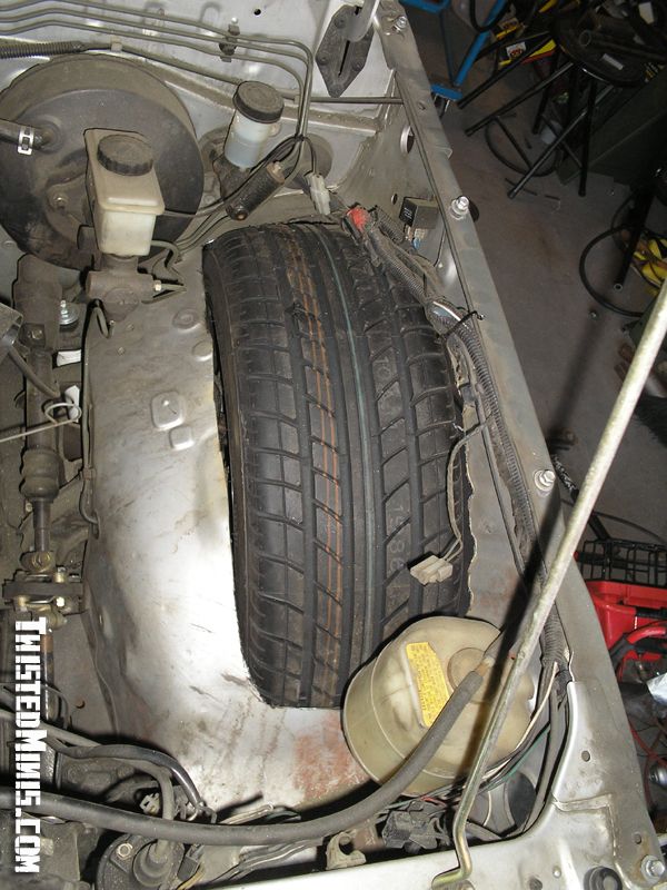

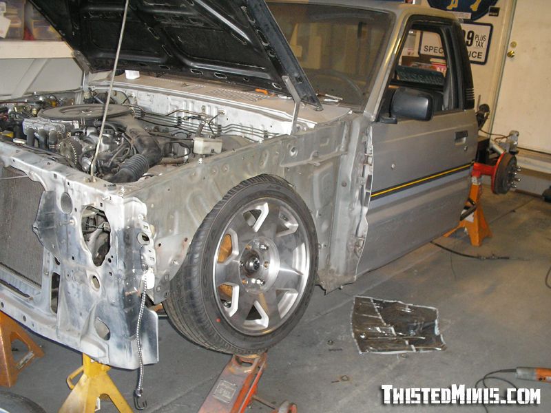

Cut about an inch around the tire on the sides and you'll be fine.
And from the side it will look like this.
