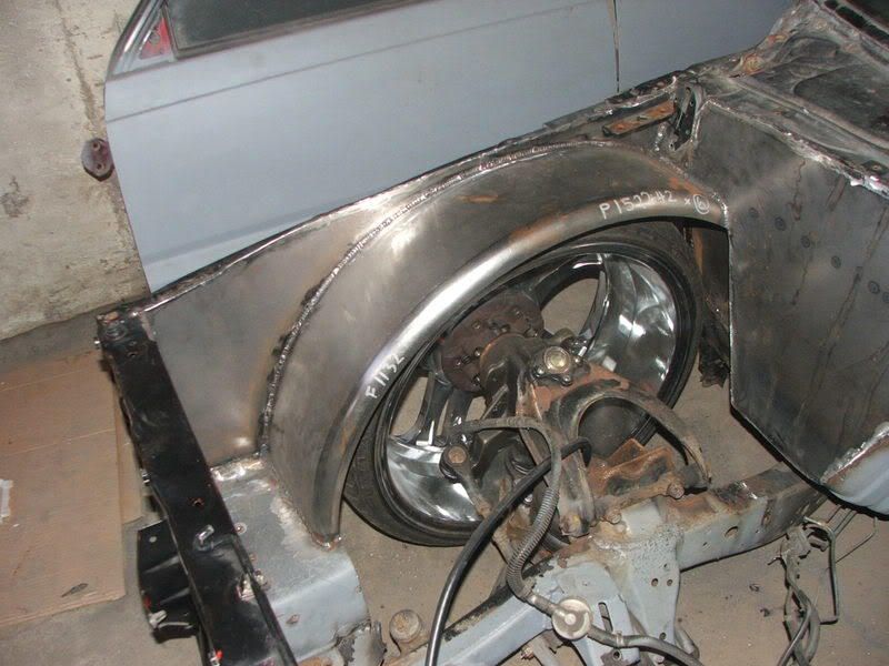

are u planning on body dropping it?
on mine in order to lay the 20's we used aim drop spindles and reangled the upper ball joints about 20 degrees, instead of spindles i would "z' the frame,
as for the 20x7.5 with the +40 offset should tuck fine, i would run a 30 series tire if u are body dropped

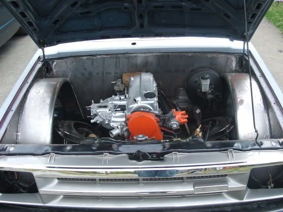

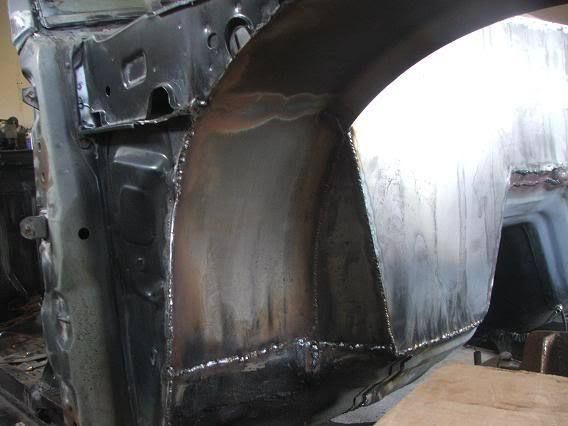

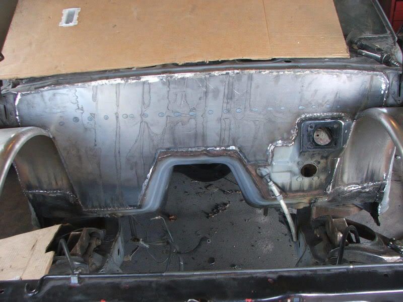

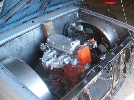

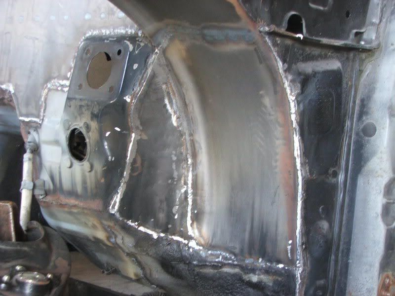

hey flameds10, is your truck BD? I have a 2.5 Stock floor bd and i'd love to run 20's. I heard it wont lay frame with that tho. Not without tubbing the firewall. Is this true for you?
flameds10(tyler)'s avatar
flameds10(tyler)
mine is body dropped to the pinch(2inches)and lays frame, 20's definatly hit the firwall, just tub it out like we did on mine
