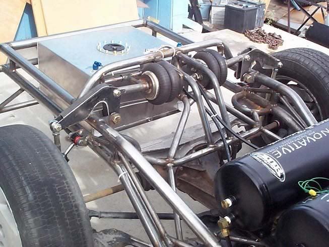

if all goes right ill have my irs setup in a couple of weeks, i wanna see some of yours, i need a few more ideas. So whatcha got?

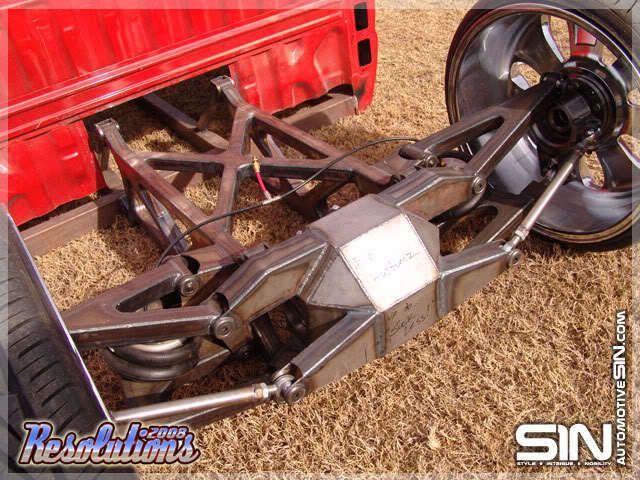

where did you find this pic?^^^^ whose truck is it? do you have any more of the front suspension?
this one looks cool as hell, but i don't know how strong it is... the whole rear frame section is only held on by 4 bolts...

lol... how many bolts is anyones rear end held on by??? 4-link = 4, 3-link = 3

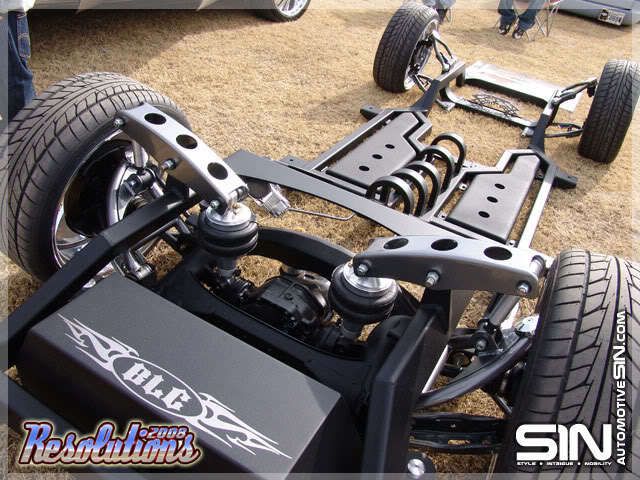

this is something ive always wanted to see in a truck, a nissan z32/s14 rear setup. it utilizes a infiniti q45 lsd with 240sx arms and 300zx hubs. the lsd is bulletproof so you could run a lot of power and the 300zx hubs give you big brake options and 5 lug. we are currently doing it in our 510 right now.
