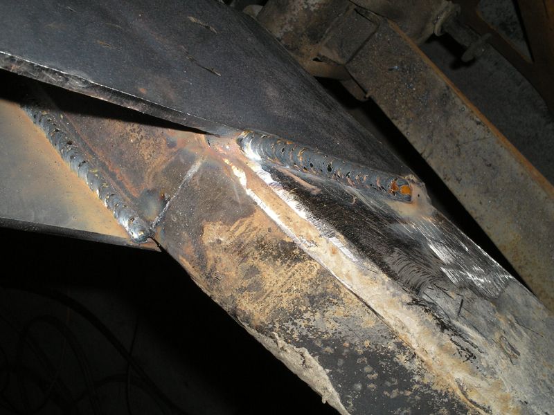

lofosho86
ok,so i made my own!tell me what you think!
hex0rz
Seth, those are some TASTY freakin' welds man! And I thought I was good, lol!
dropndragmazda's avatar
dropndragmazda
lofosho, thats a pretty NICE notch bro
