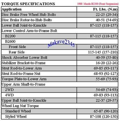

found this on my computer. enjoy.

thats very helpful man
dragn37
yeah, thanks
