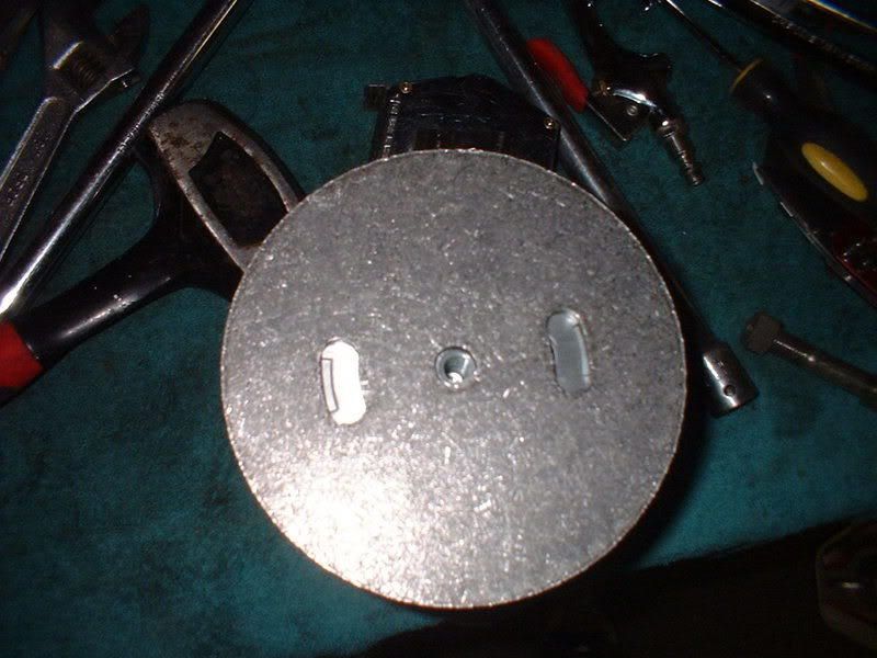

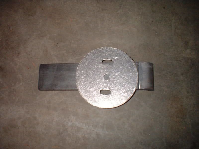

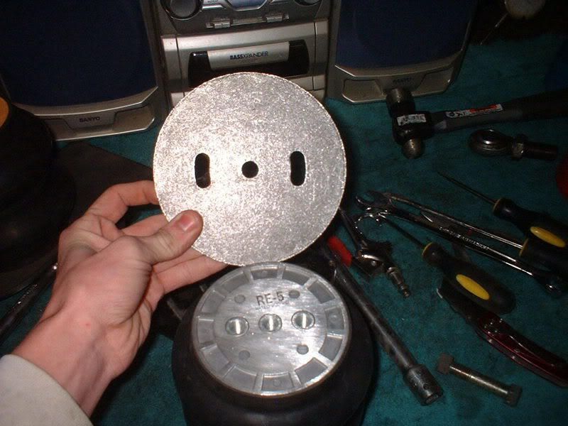

How the hell do you mount the plate to the A-arm and then bolt it to the bag? The bag plates dont line up with the 2 outer holes on the bag.
dragginmazda86 (dave)
This is how myself and most people do the lower bag mount. Hope Seth doesn't mind i posted one of his pictures but I dont have any of mine. Also you just use the center bolt hole.
