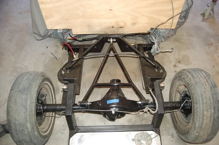

check my pics man.i've got a parallel 4 link with a panhard!havn't driven anybody else's so i couldnt tell u the diff in the ride!but mines pretty damn good!

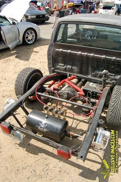

mazdawg(mikey) avatar
mazdawg(mikey)
like i did mine
poorboysporttrucks avatar
poorboysporttrucks
Sweet truck.
