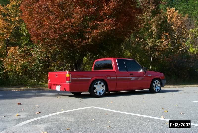

I recently lowered my b2000 and i noticed that when i turn sometimes i see the wheel move in and out, like the axle is shifting a little when i turn. any help would be great. thanks
Info: front- cranks torsions
rear- removed two leafs, so i have 1 leaf and the helper on top of 3" blocks.
