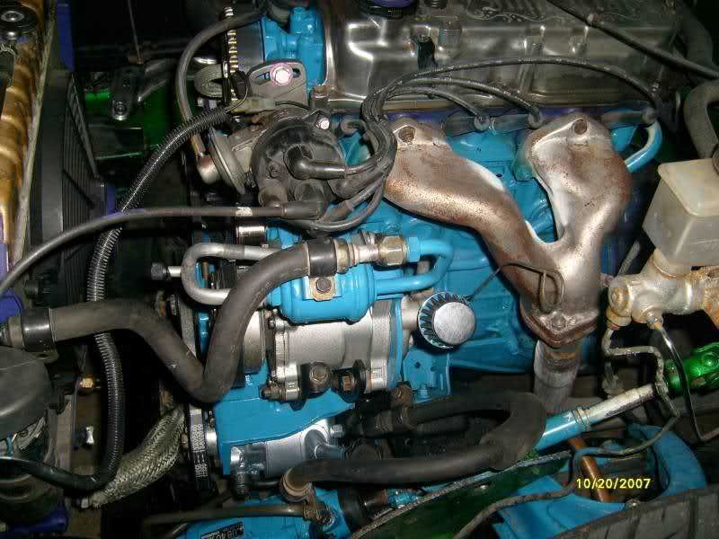

Have a 508 on the daughters truck with the factory brackets. Can only say WOW. I mean the AZ pumps air better than any other single electric compressor.... but, you switch over to the EDC and its like having 4 AZ's running at the same time.

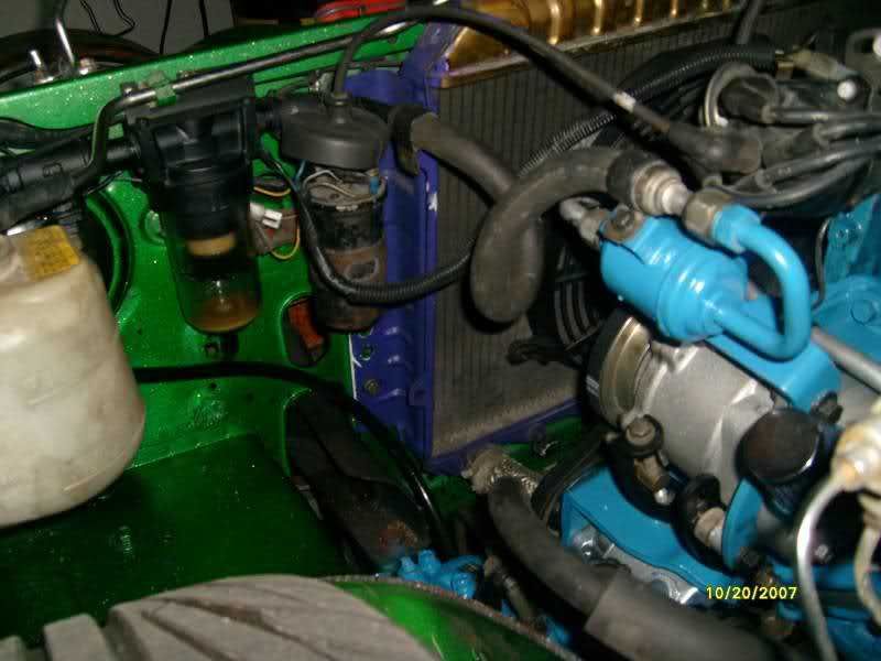

I personally do not have an in-line oiler. I have been adding oil thru the plug on the top frequently and draining the oil/water separator just as frequently - but IMO it's worth it!
