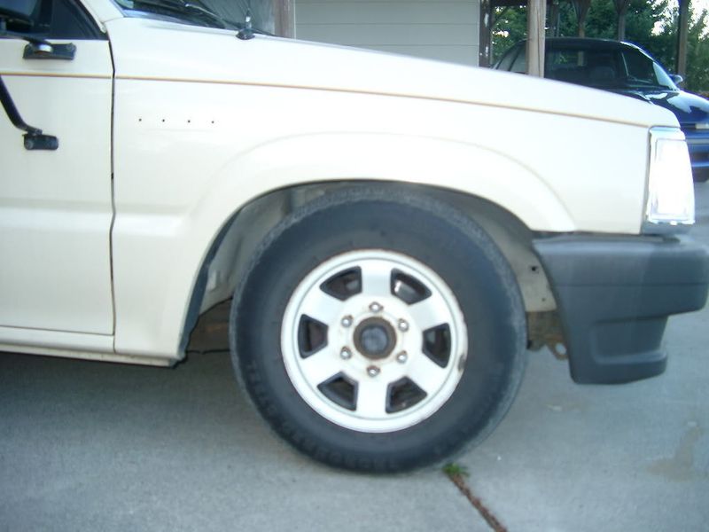

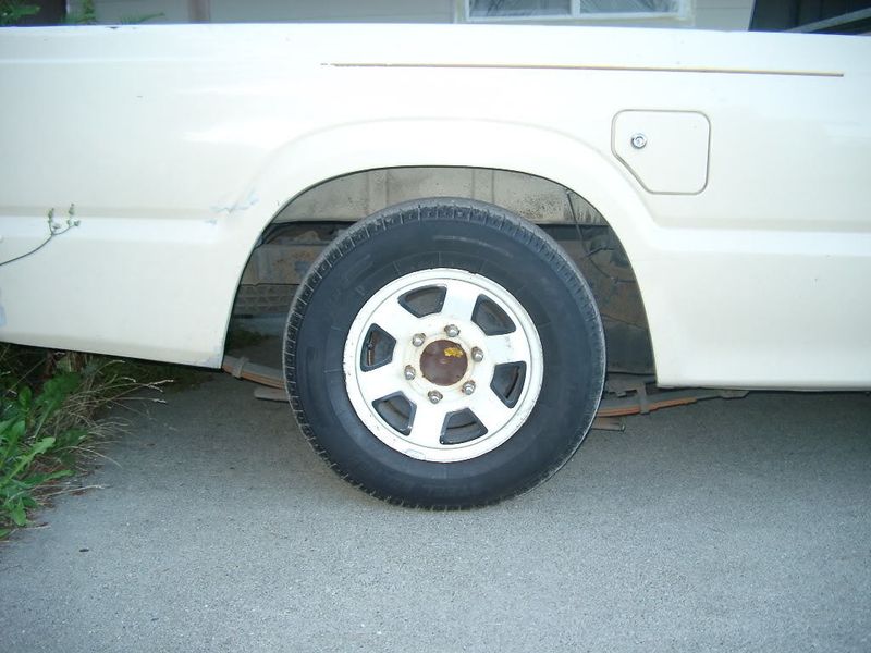

mazda86
here is my 86 the front has 3inch drop control arms and the back has the 4 inch blocks. The front is perfect (actually the tires rub on the outer rim of the wheel well) but the back still need to come down.
