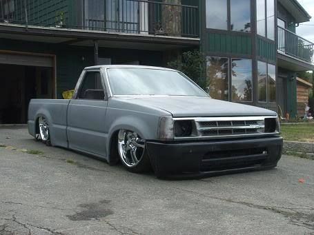

i gotta know how hard this is to go this low....
flameds10(tyler)'s avatar
flameds10(tyler)
i used spindles, if i were to do it again i would say fuck the spindles and z the frame
mr.bbs
that shizz is off da hook pal... nice werk
mazberrydelight's avatar
mazberrydelight
i did flameds10s suspension , if it was my own personal truck i would have Z the frame 1/2&quot; and not bought spindles, but at the time he was scared of letting me cut it up. few beers and reach arounds later and he does whatever i tell him to do , hes a broken man
