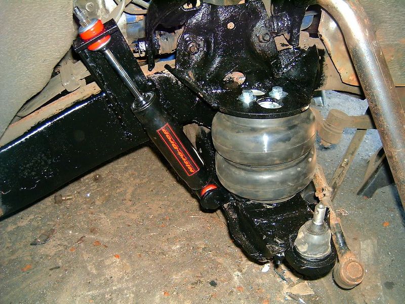

What do you recomend??? gussets goin up \____/ or gusset goin down /---\ ???
i would think up

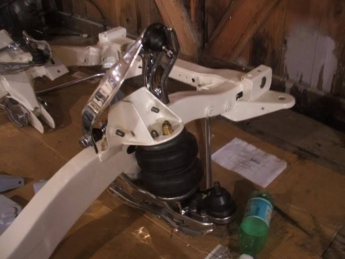

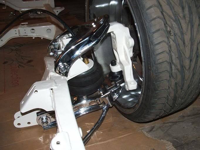

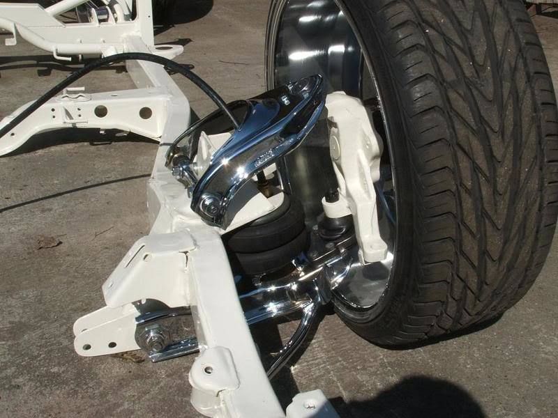

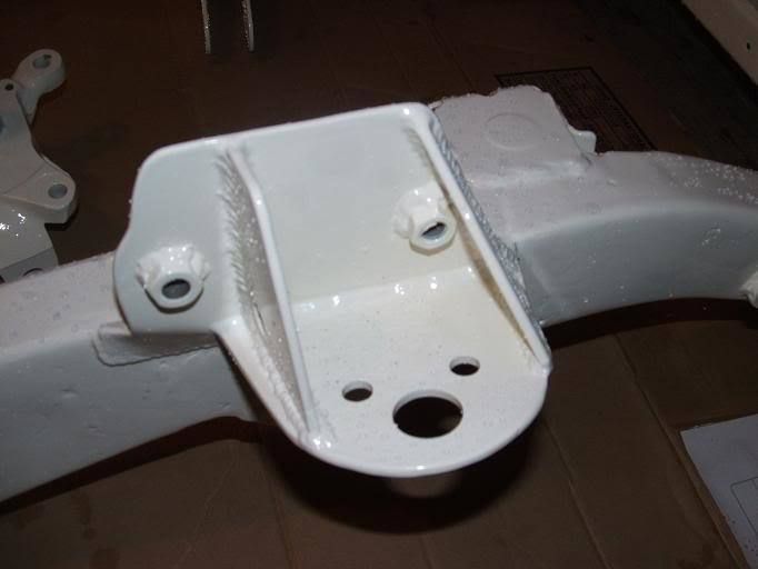

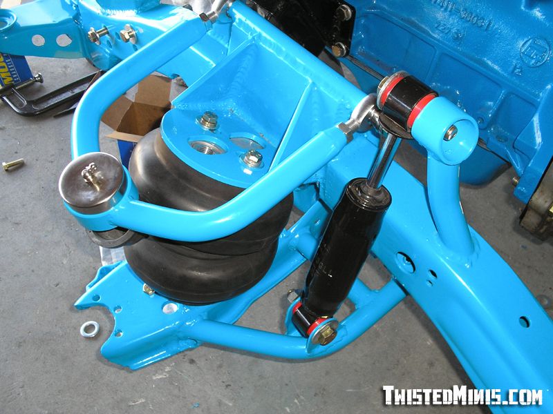

Seemed to work better in this application.
