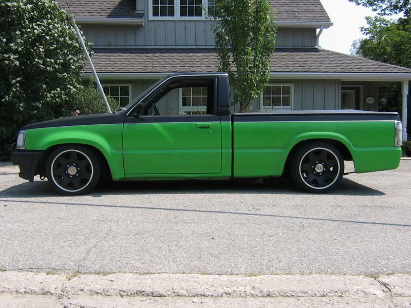

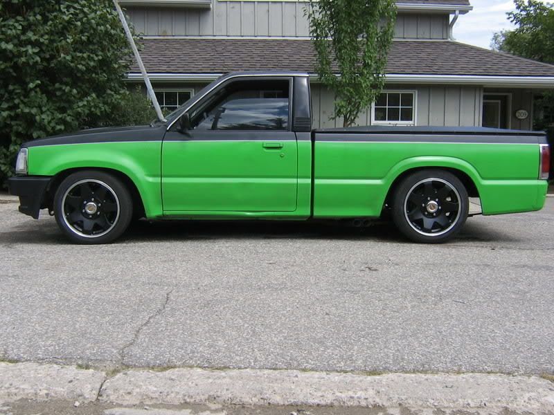

mazdawg93
heres my truck with the aim drop spindles and 205/40/17 tires.

I like the 205 40 17 look that MazDawg93 has on his truck and if we need to space it that will not be a problem at all.
