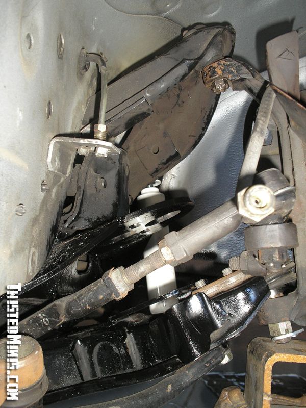

nothing like a good ole picture for an answer. but it depends on what size rims and tires you are using also. whether you have spindles or not. a little more info would help. but i think most people are putting them right above the hole in the frame

you need to mount it as high on the frame as possible and angle it upwards just a little bit.

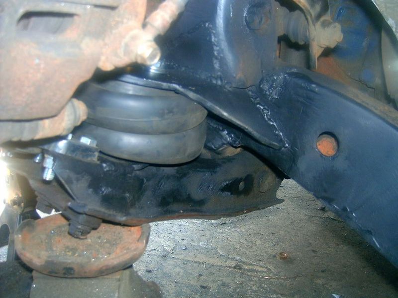

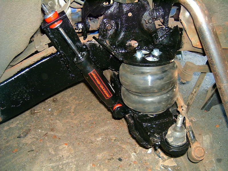

Well in cid's truck he is runnig 16's and I made room so he could and can run up to 18's and still lay full frame. here is the front done.
and here it is slammmed out just before the shock is installed.

you dont have to notch it but its going to give you less metal to burn into when you weld your plate yea you can gusset it but id rather take the time and notch it and also gusset it then you have that much more insurance that everything will hold together

the piece were the outside support for the a arm goes down the outside of the frame look in the above pics you should be able to pic out what were talking about
