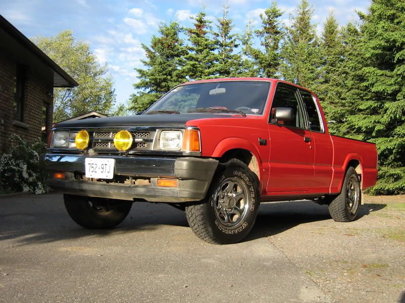

How she go boys and girls.
As some of you know my trucks pretty high right now.. lol.
Im going to that IllConformity Summer Shocker in 2 weeks or so, What im planning on doing is buying a set of 4 inch blocks tonight, and putting them in. I also want to take 2 leaf springs out, and Re-index my bars so it will be how i had it before but a little lower.
Basically just want to get rid of the rake and have it tucking all around, even a little bit.
So the thing im wondering is how do i take leafs out?? I've never really fully understood how your supposed to do it. I dont think I'm going to take them out if you have to take the whole spring pack out of the truck. I have the feeling that stuff will start breaking if i do. Can someone please explain in detail how your supposed to do this?
Give me some advice..thoughts..opinions.. lol
