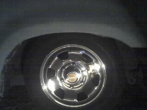

Im running static right now with no torsions and have 205/60/15s. Can I remove my bumpstop brackets cause I don't have any up front and some times it slaps my LCA.
lowblownranger
if you remove you bump stop mount youll be riding on completely bottomed out shocks NOT SAFE i mean i did it but i wouldnt recamend it not a nice ride either you ll prolly also have cut the inner fenders if you havent already not real sure my truck with 14's almost tucked 2 inches of tire

Ya thats kind what i was thinking. Im going to have to fab some sort of cusion though cause the mount almost sits on the LCA as is. I wish I had the money to drop on a front bag setup

do like i did!!
i have no torsions...
i run 185*75*14's...
i took the upper bumpstop and put it in the lower bumpstop mount...
its softer rubber and smashes flatter...
i tuck most of my tire...
