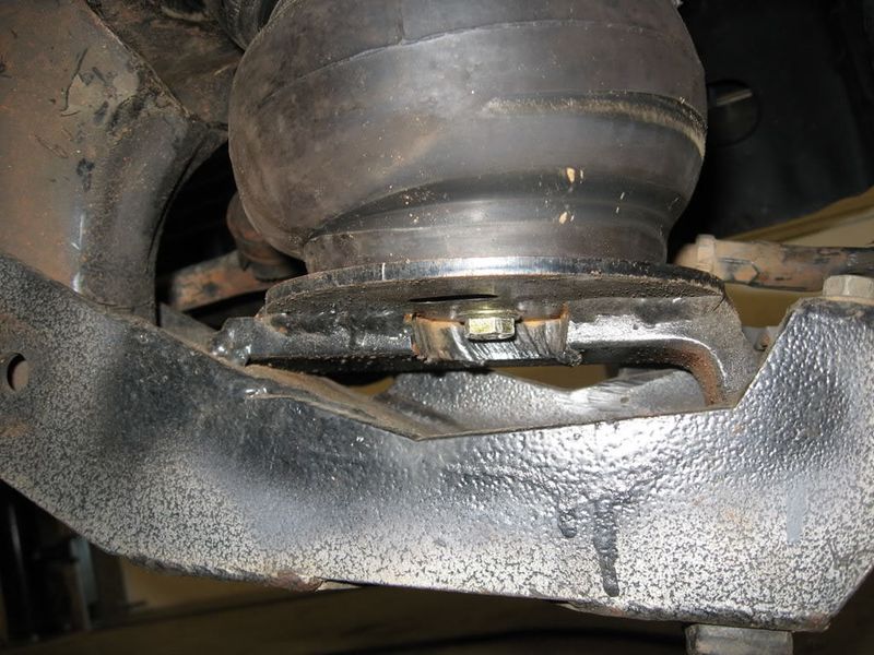

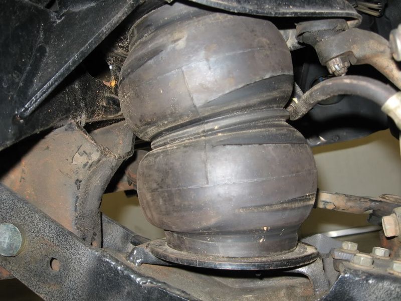

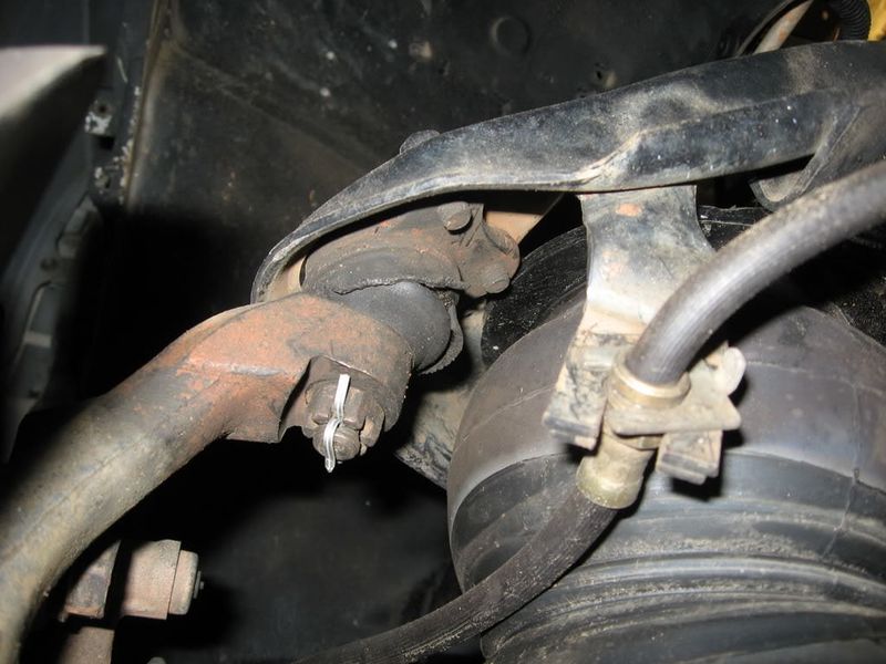

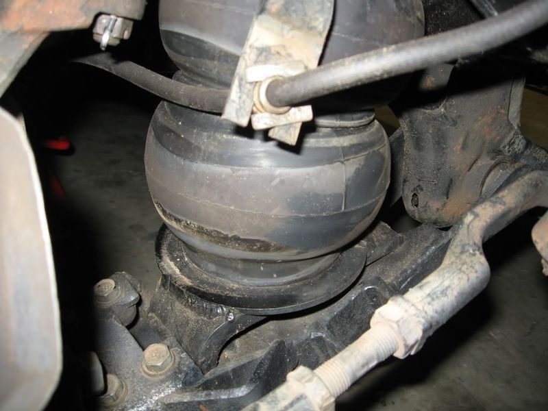

here are some pics of mine on djm lower control arms

Ya thats cool but what about when you are layed out.
reflectorcollector's avatar
reflectorcollector
the ball joint doesn't touch at all when it is laid out...the frame barely touches when it is laid out but like i said i am just going to notch it in with 4x2 box tubing cut in half and it will be perfect

Do you have pics of it layed out I have a couple of guys that told me that it just wouldn't work and I told them I could make it work so if you put up pics I can get them to keep there djm arms and finish bagging they're trucks.
