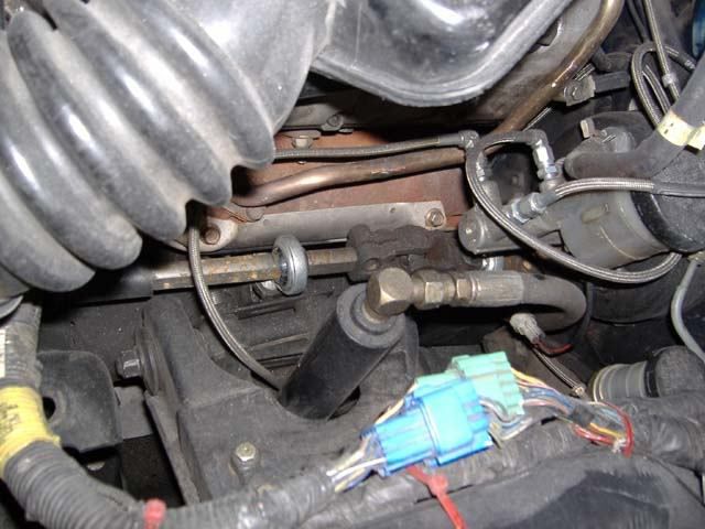

You can save yourself a bunch of cash if you can find the mid 90s T-birds at your local pick n pull. They have a standard DD joint at the end of the steering column right before it goes thru the firewall. I used 2 of them and some standard DD rod that I got at the local hot rod shop, and I have 2 heims in there to keep it all nice and tight, 1 you can see right below the brake booster and the other in plain site.
Good luck with the mods.

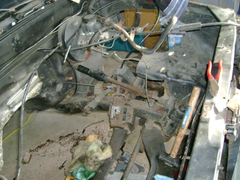

slamsuzu
sicpupidaho - I bought a steering column in louisville KY this week and used the extra knuckle to make it work......
steering column = 8.00 bucks from pull a part in louisville KY
sicpupidaho sent me a pic = thanks
My steering coulmn = badass!!!!
Ill post pics tommorrow....
