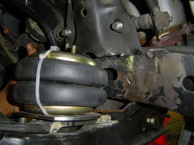

anybody have a close up of this thing installed??

Don't know if this helps but... a picture may be worth a 1,000 words...
Like BagdB2200, L bar gets welded to the LCA to make the bottom plate parallel with the top plate when the bag is compressed.
