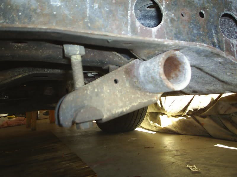

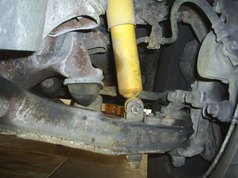

i had my bars cranked when i bought the truck a year ago and dont know why i cant get it lower.
its not hitting the bump stops and im willing to cut them off in a second!
lowblownranger
well i see you have already flipped the ball joints or they were flipped.... hack off the bump stops..... is your shock bottomed out ??

Remove the bump stops first and foremost. Then I'd take the bars out and reindex'm a notch or 2 cuz that torsion bracket is hanging way too low already imo.
lowblownranger
i agree on reindexing them just know that reindexing them wont make you lower but it will get that bracket closer to the bottom of the truck and less chance of ripping it off then
