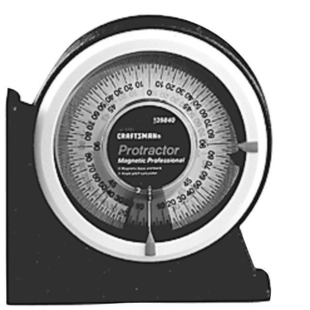

pinion angle should be around 3* positive (up in front) it should be ok anywhere from like 0-7 degrees. but try to get close to 3*
speedster93b's avatar
speedster93b
oh and how you measure it... at sears they sell a circular angle finder for around ten dollars. put it on your pinion yolk face and see what the angle finder points to.
i can't post the pic so here's what i'm talking about.

I just picked on of those up a couple days ago

yeah i got one a while back and damn, great infestment!!
