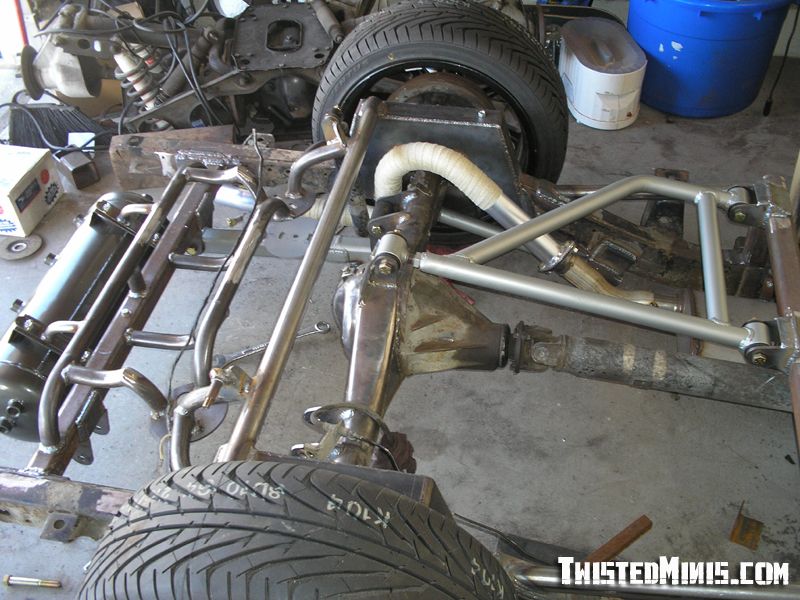

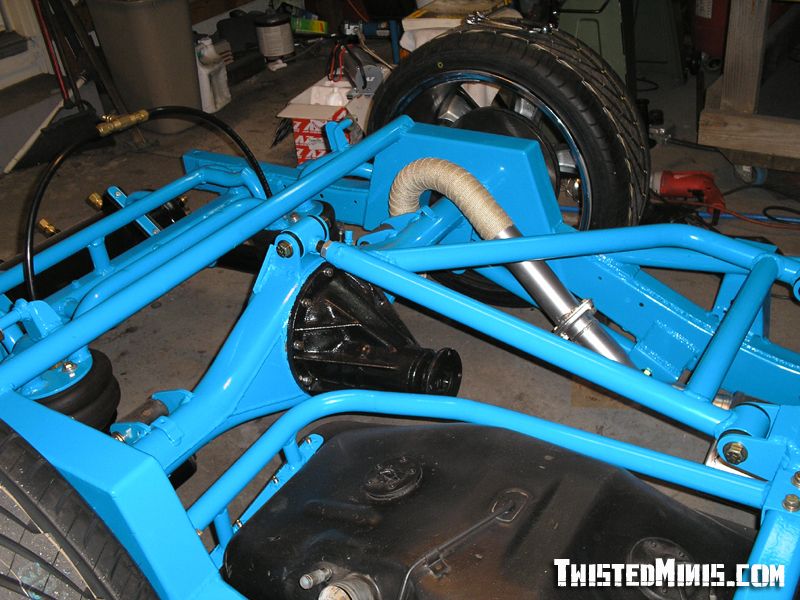

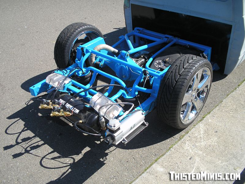

Well in that case, you can do something like what I did.
It will cost you a little bit more. You can't simply just put the bags ont he front bars. Theres not enough room, so you need to do rear lift bars like on the SD setup. I have a forward 3 link (upper bar, and one on each side that mount near the stock leaf spring perch), with two rear lift bars on shackles. The shackles are off of a 73-87 2WD chevy, very cheap and easy to get a hold of. I think I have around $500-600 in my rear setup, with bags.
Hope that helps. You have any questions about how it works just ask, I'm glad to help.
Also, it rides great, and gets an easy 10 inches of lift. Way more than necessary. But it rides great 1/2" off the ground, all the way up to about 9" off the ground.

Yeah I've seen that before. Man I love your set up! That's some crazy bending going on for your bag mounts. Mine'll have to be much simpler lol. But you only $500-$600 in all that? You didn't do the welding/metal work??
That's exactly the wishbone I was thinking of. I won't have to build a frame and stuff around my tank will I?

You may have to build a cradle around your stock tank like I did, to support it. But you might now. I'm not familiar with the way a Mazda looks stock. The one I got here came pre-cut.
I did all the work myself though, thats why it was cheaper. The $500-600 is materials, links, bushings, tabs, etc.
