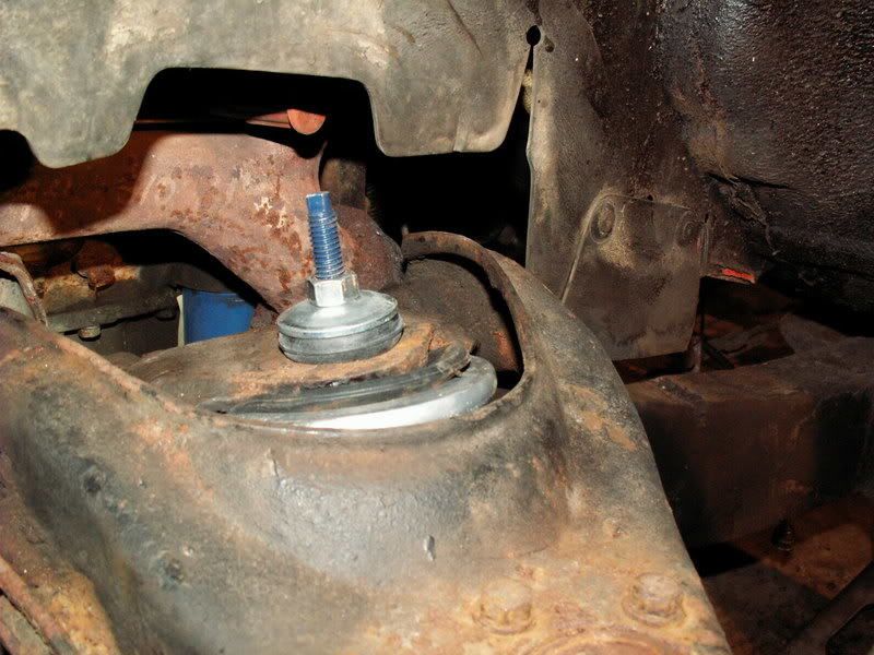

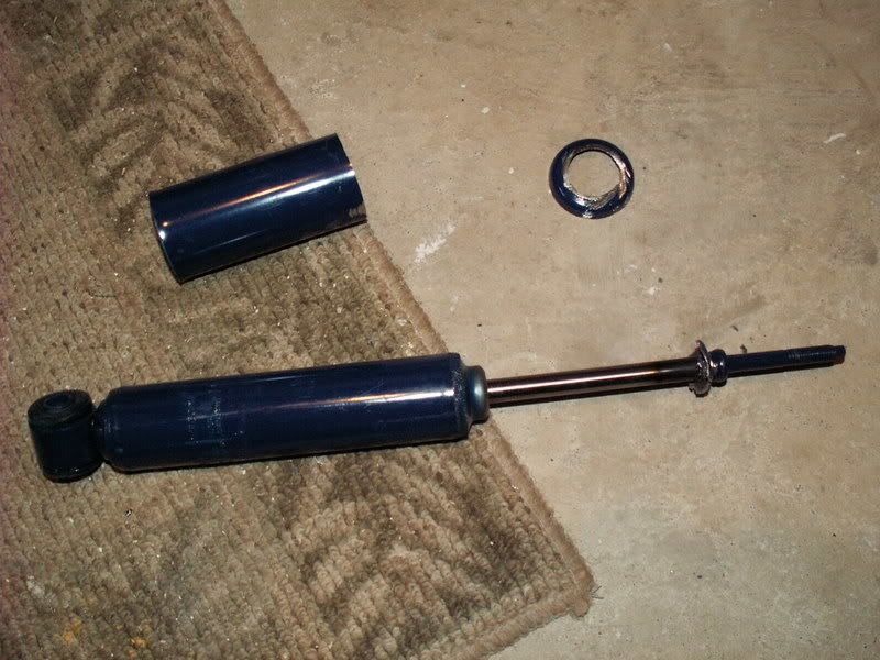

Here's a preview. I intend to do a full write-up after I have a chance to evaulate them. Truck needs a trans for that though...

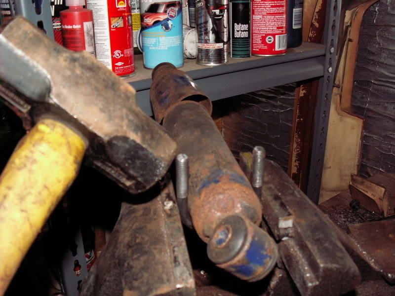

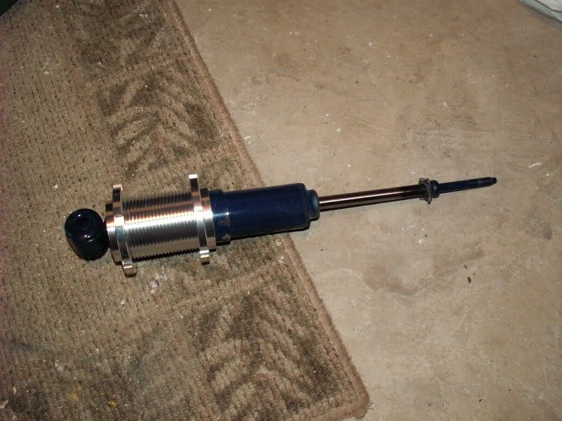

Building coilovers (stock shocks, ebay coilovers, QA1 springs):

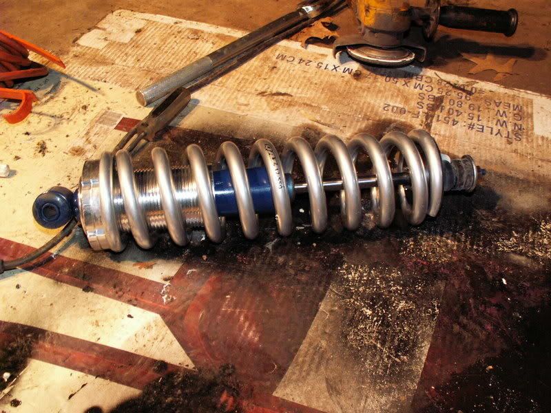

Making a spring perch out of an exhaust clamp:

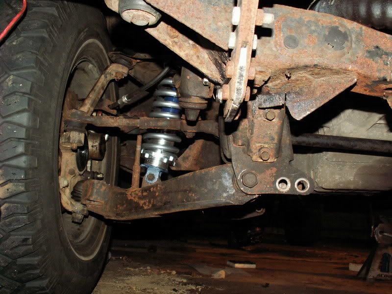

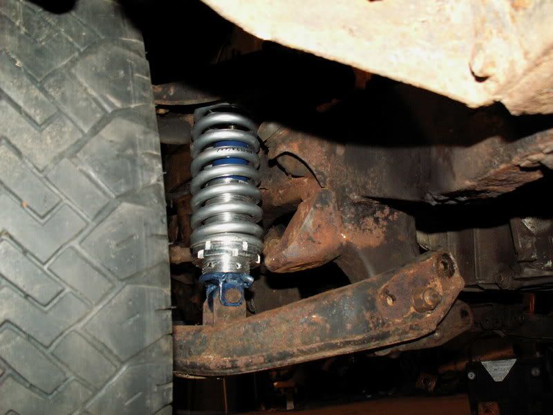

In vehicle:

That's 4x4 suspension welded onto a 2wd. Still working on the front diff!
Coilovers are SOOO much cheaper this way. I paid $40 for shocks, $40 for the sleeve kit, and about $70 for the springs. The only downfall (so far) is that I had to fabricate a spring perch to keep the coilover sleeves from falling off the shock body.
