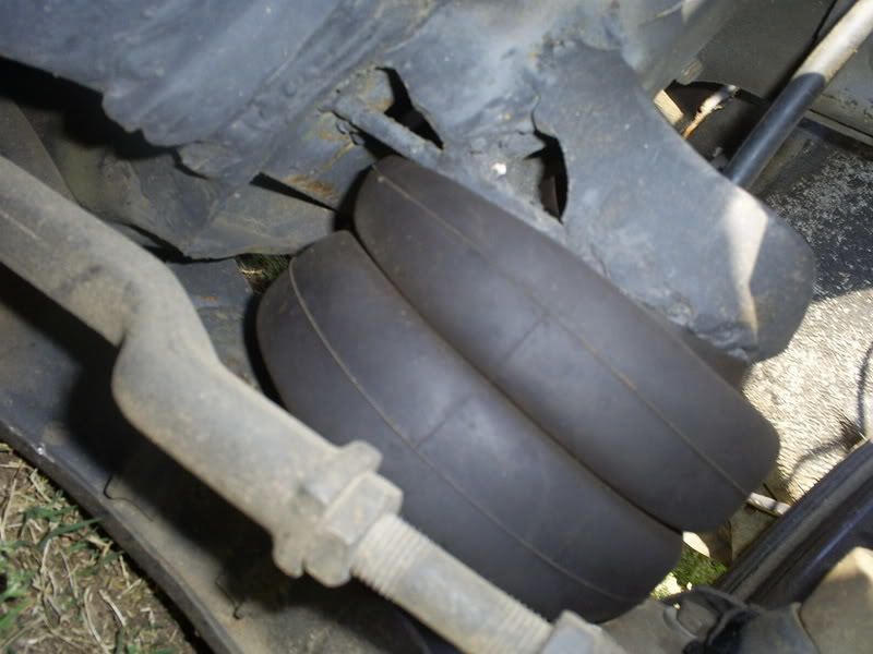

i dont know if this will help but.
slamditbig's avatar
slamditbig
i dont know if this will help but. these are slam 2600's

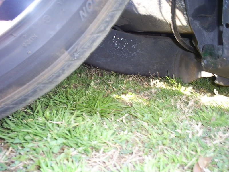

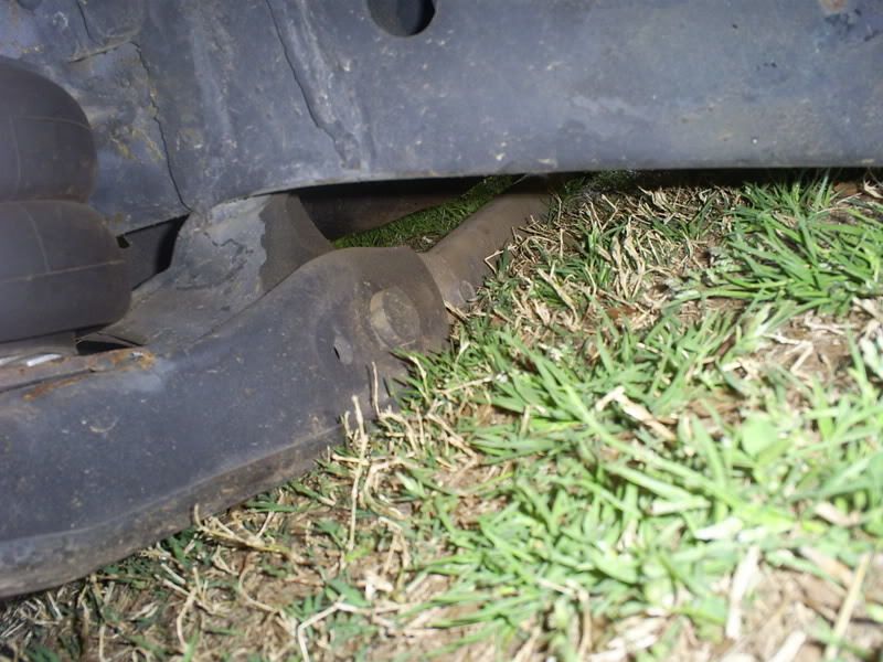

slamditbig's avatar
slamditbig
yeah it lays out, i have drop spindles so that helps out. these pics dont show the frame but i will take some today of the frame on the ground. if it doesnt its really close not eough to tell
slamditbig's avatar
slamditbig
here ya go i know its in grass but oh well

balcar
Slamitbig, looks like the bag is rubbing the mount on the back side. Got to be carefull about that. I've done a few, all you have to do is cut out a bit of the frame and cup it with either some tubing or just some flate plate. I'll take pics of one i'm doing next month and post them. Its not hard, but its definatly worth doing a larger bag on the mazda trucks.
