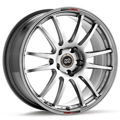

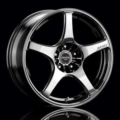

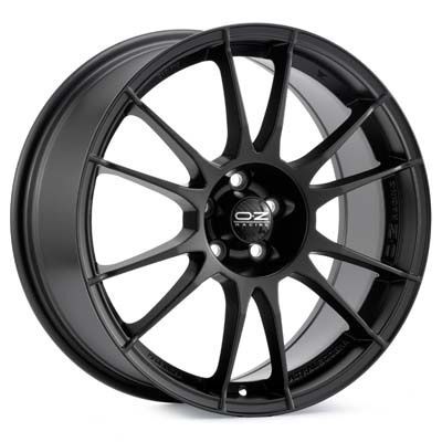

225/50-16 falken ziex 512's on 16x7 centerline sunray 6's...would like to go with one of these light weight wheels in an 18" variety.
enkie racing series gtc01
or rp03's
or some oz ultraleggra's
maztang (ryan)'s avatar
maztang (ryan)
i like the rp03's.
