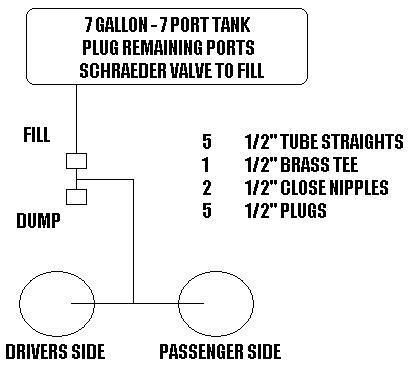

Hey, i wanna do a ball valve (temporary til money comes in) setup...
with only a front setup, would this work?
slamditbig's avatar
slamditbig
yeah that is the way mine is set up. my valves just came in though

a buddy of mine had that on a handa just the front
laydoutb26's avatar
laydoutb26
so that would work? i'm gonna be running a 7 gallon tank with no compressor for a while... i will air the tank up before i leave home everytime...

that would get on my nurvs havin to air it up all the time like that but yes it should work

i had a friend that ran it on all 4 corners. he did it with 6 ball valves. id have to draw a pic if you want. he had 2 main and 4 corner valves. he opened which corner he wanted and then opened a main one. so lets say he wanted the front up, he would open the two front and then open the main feed. then if he wanted to dump the front he would leave them open and open the main dump. kinda crude but way cheap and effective. he had it all neatly in a concole between the seats. you never saw it.

i don't know about running it without a compressor man, you will run out of air real quick. you may want to check and see if you can rent nitorgen bottles locally.

yeah, i'll second the 'running without a compressor is kinda sketchy' notion. while on paper it might seem like a good idea, you'll get suckered into 'hittin switches' - or in your case twistin ballvavles - and be outta air and it sucks. you'll have the new sensation of going up and down and it'll be the shit and you'll want to do it at every stopsign and red light.
renting a nitrogen bottle wouln't be a bad way to go, i personally think its kinda costly in the long run, but till you get a couple compressors you'll be golden.
