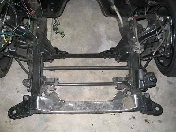

mazdamandan's avatar
mazdamandan
I found this pic this may help in the idea dept for the crossmember
F
fantomrush
Cool thanks. I might use that idea.
devb22's avatar
devb22
THat seems like a good idea, looks clean!
