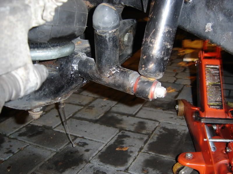

I wanted to run this by you guys here to see what you think about this idea. I'm going to fab my shocks mounts hopefully this weekend while its' nice out.
I plan on getting some 1" DOM tubing with 1/4" wall. That leaves an opening in the center of the tube at about 1/2". Its actually about 7/16" so that is a little better. I have the shock relocation kit from SD that has the lower stud with the smooth end to keep from tearing up wheels and tires if they rub. I plan on taping the inside of the tubing so I can screw in the SD lower mount to keep the smooth end. I figured it would be hard to get it tight enough to keep it from coming loose. I plan to solve that problem by using a grade 8 nut on it as a lock nut that will tighten up against the tubing kinda like the 4 link ends.
What do you guys think about this? Good idea... bad idea... or should I just weld a stud on the end of the tubing and have a nut on the end like Phatkix did for his lower mounts. . Thanks for the pic Phatkix.

phatkix's avatar
phatkix
heres the pic, the link didn't seem to be working
F
fantomrush
yeah I didn't pu the image tags around it. I didn't want to use up any of your Photobucket bandwidth since I didnt ask if it was ok to post that pic here. Figured people could just click on it if they wanted to see it. lol
