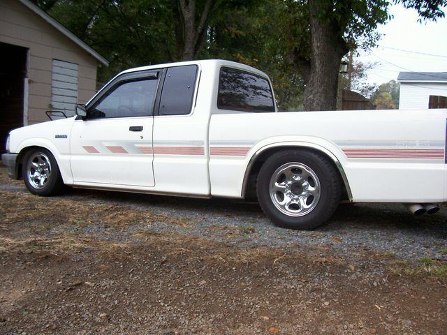

And now I am like this:
I got this way by, flipping the front bj's, reindexed the torsions 2 notches (had to replace the t-bolts due to bolt breaking, so while I was at it I reindexed), monoleafed rear with overload spring, 3" angled blocks, shaved rear bump stops, air shocks in the rear, Isuzu shox up front with bump stops removed.
I keep my rear end aired up a bit or else I'll ride on the shaved bump stops, so up front and in the rear I have about 1" of travel lol. The front still has the bump stop brackets...for now, and that's what I hit on hard bumps with the lower control arm...making for some hard hits on big bumps. The ride is fine on most roads, no bounceyness, but tightens your butthole when you see a bigger bump ahead
