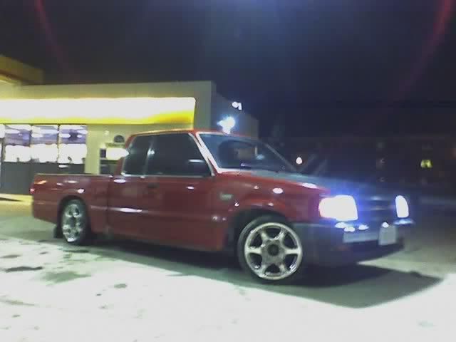

Hey everyone. Ive got a 86 Mazda B2000.
I got it in August of 06, bone stock, and have been doing stuff to it since.
Right now its got:
-A 3" Belltech Block
~2" Cranked Torsions
-GM Yukon Denali's Wrapped in 205 40 17s.
-No Rear Bumpstops
Other Than this, Its stock suspension. Needs to go down more, fair bit of fender gap now.
I want to be about 3" or so lower this summer. What would be the best way of lowering it with what I've already got?...I know i'll be putting my monoleaf in, but how about the front?
BJs...whats the advantage of flipping them?
Control Arm or Spindle? Which?? And why??
Any advice would be sweetness. thanks a mill.
